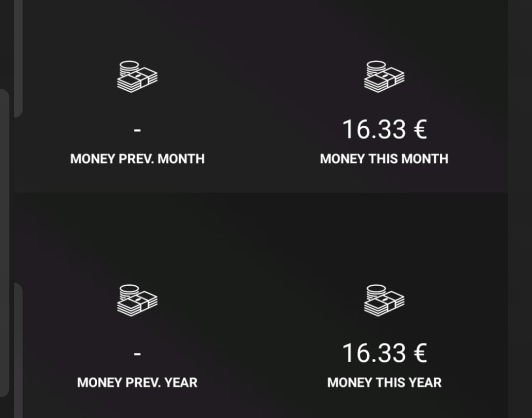

Hi Robin, thanks voor the hard work and great app.
Can this be a bug (v4.9.1)?
The month and year money values are equal, for both energy and gas?
The kWh and m³ values are correct.
The this_year value will be equal to the this_month value when there has not been any information collected prior to this_month. That is for instance the case right after adding the PBTH device. You need to wait for the next month to see a difference. Or alternatively you can go to advanced device settings and manually fill the this_year value.
It could also have be caused by a migration bug that was introduced in 4.9.0. Was fixed after that so should not appear anymore.
Thx for quick reply, Robin. I started last september.
Looking at the reset day, it looks like it’s due to the bug. Case closed!
