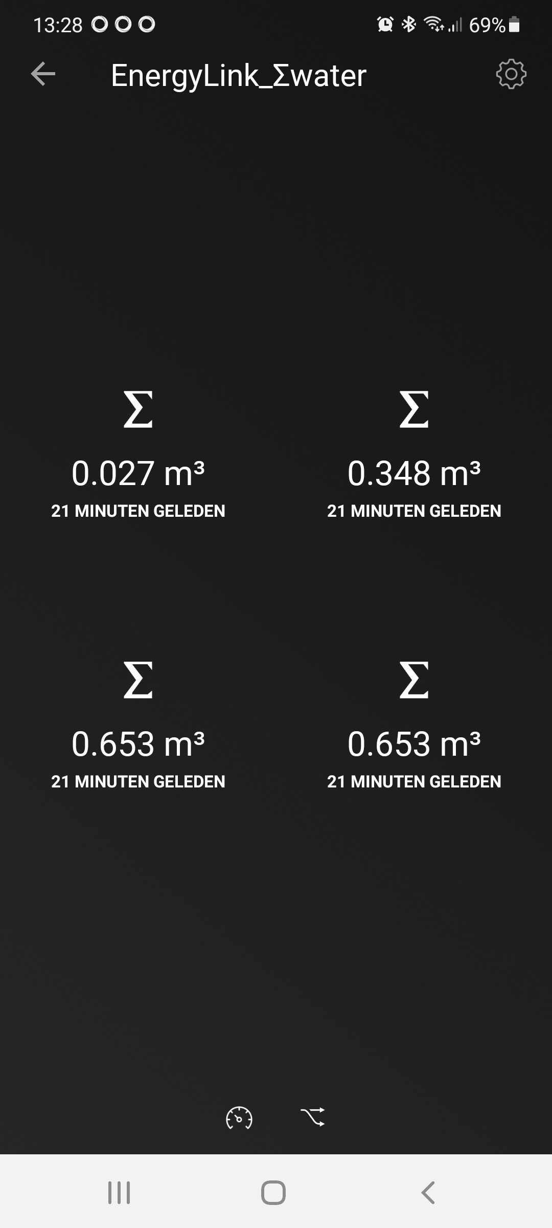

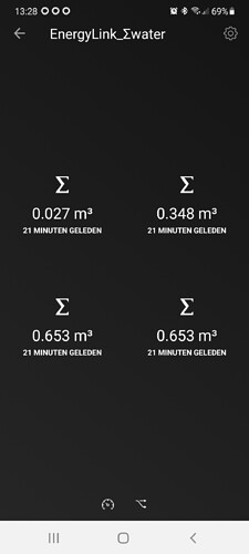

Hello @Gruijter , as you can see the hour and day consumption is OK. But the month and year consumption is not correct. Yesterday before 0:00 everything reset and checked to 0.

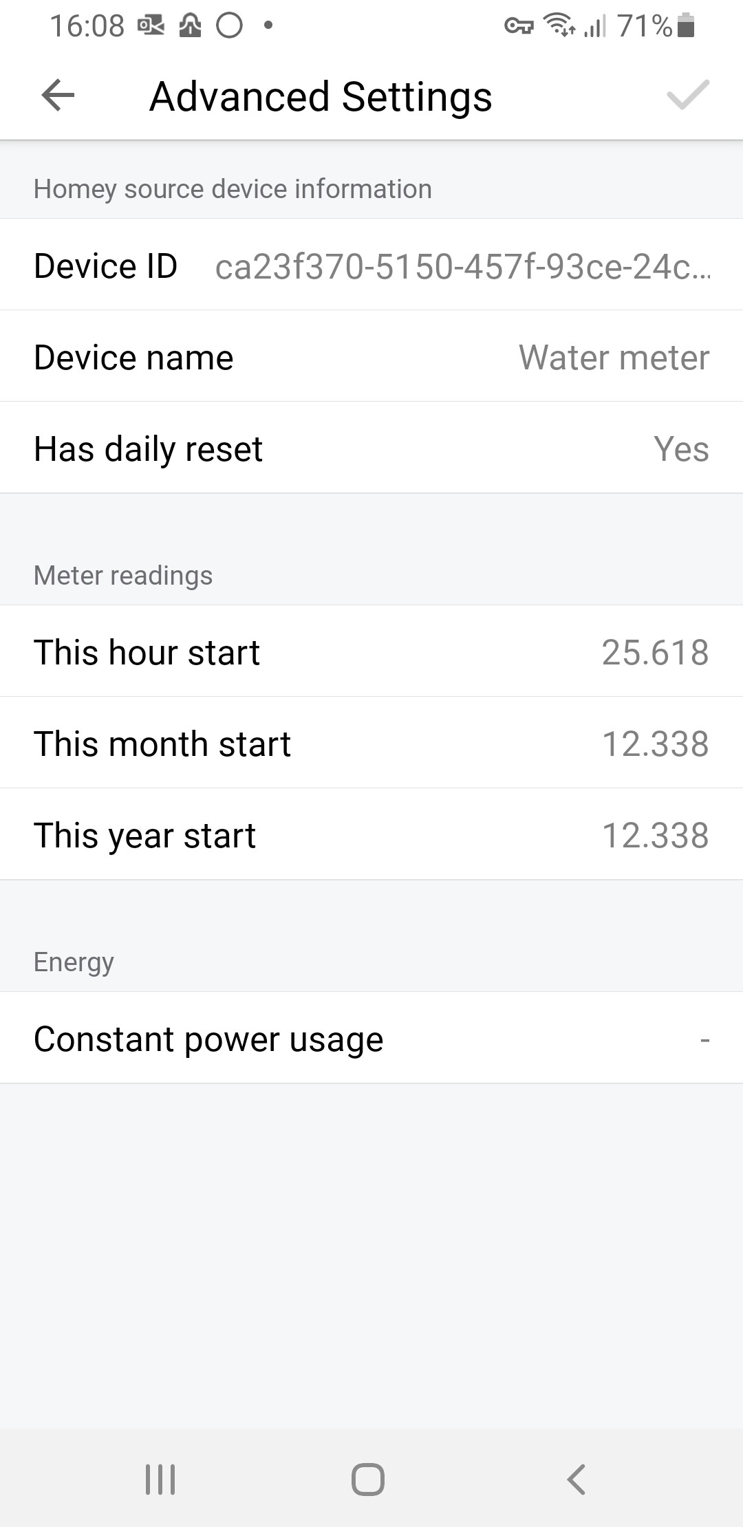

They seem correct to me when you only started yesterday. Did you fill in the start of month and start of year meter values? Since the source device does not provide the real water meter value you need to fill in negative numbers.
all values ​​started at zero
That might be the reason my PBTH power device is not showing what I want to see. In my case it shows the delivered power, but the returned power is not subtracted in the statistics.
Indeed. And to know how much your solar panels produce you need a seperate meter for them anyways.
Ton, I mean what did you fill in at the advanced device settings. You need to fill in negative numbers for month start and year start
I entered zero for all three
