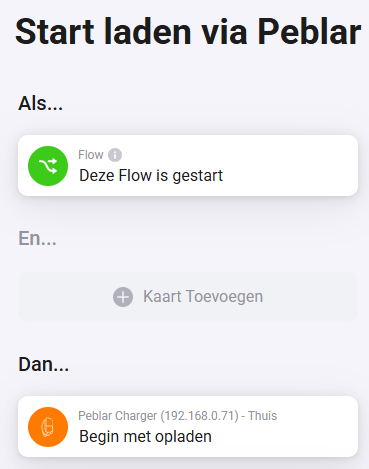

No, I’m using a flow to start charging:
Ah okay, I dont really use that myself I just plug my car in and it starts charging.
Starting and Stopping charging is nothing more than setting the A to 0 or the maximum. And I think that is not working properly.

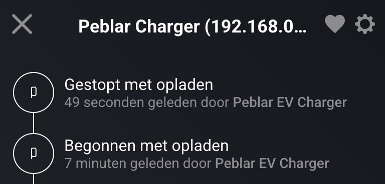

Thanks a lot! I’ve updated the app, tried to start the charger via the flow and via button, but both times, it starts and stops immediately.

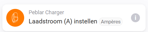

Update, it’s working now. But not via the start/stop, but by setting charging amps to 16A:
I noticed that aswell.
Will hopefully put a fix out tonight
I just released update 2.1.0 to fix the on/off button issue.
