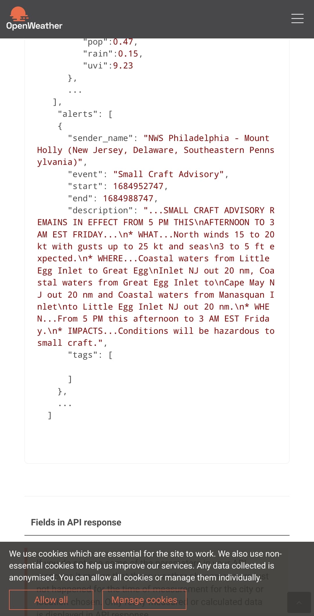

Just as example a weather alert:
API response:
grafik
Btw… this is an english alert for german request. So it depends on quality of your local weather provider used by OWM.
