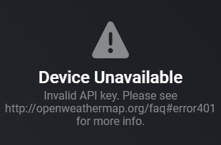

I cannot get it to work, keeps telling me
Device Unavailable
Invalid API key. Please see Frequently Asked Questions - OpenWeatherMap for more info.
error401

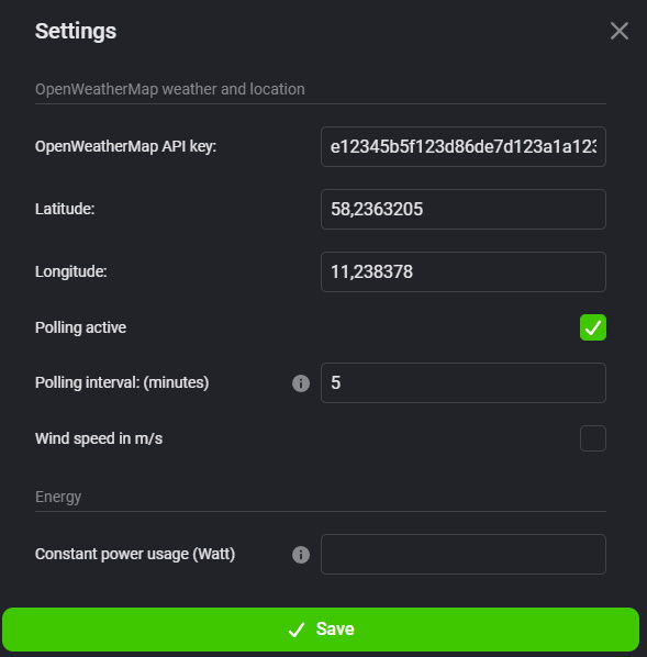

Just now I took the API from the device in homey, pasted it into notepad,
then took the number from the URL test, and pasted it into notepad just below the others, just to make sure they are the same…
Sorry, I have no idea at the moment what’s wrong. Reading the geolocation (getting the city list) is also using the API key. So if you see the cities, all is ok. And if you can see the API key in device settings, that means that your settings from add device dialog is stored correctly.
I tested now several times in mobile app and WebApp and can’t get this issue reproduced.
