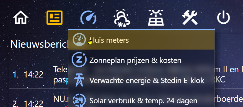

Okay, so each dashboard contains a copy of the full menu, and you use the main menu to highlight the current page while also activating or deactivating the submenu. However, if a highlighted menu item (one where the state is set to ON) is pressed, it sends a false value to the submenu (the menu items is ON and turns OFF), causing it to collapse. If the submenu is already collapsed, nothing happens, which means you have to click twice to actually open the menu. Since there is no option to set individual icon colors for menu widgets, you cannot fake a highlight by changing the “off” color. At this point, it seems it is just not possible to have a main menu highlight an item while it remains connected to a submenu.
Is it possible to press a main menu icon so that, regardless of the status of an open submenu, all submenus are closed, only the selected submenu is opened, and the selected main menu icon gets the selected icon color?
I previously showed the image below (from my “old” dash), where the orange icon is the active main menu and the blue one is the clicked menu.
This way, you always know which main menu you are in.
Perhaps I should solve this by placing a main menu name above the main menu icons.
