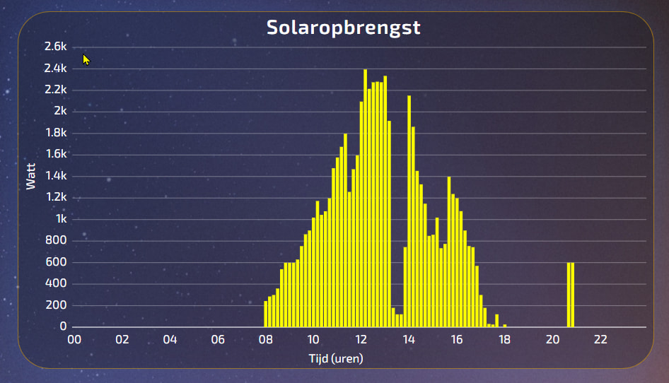

How to read the following y-axis? Setting y-axis: auto min, auto max, y-label count: 10

I am trying to see the problem, but can’t seem to find it? Do you mean the multiples of “2k”? I have updated the Y-axis with compact number formatting. 1000 = 1k, 1000000 = 1M… I struggled to keep the width the same if the numbers go up. But in your case I would increase the decimals resolution so it looks more like this (left) or change the Y intervals when using the smart intervals option (right):

Defining 1 decimal did the trick. Thank you.
I didn’t expect to have to work with decimals for large numbers in a graph. Therefore, is it always recommended to define at least one decimal?
With my NL settings, the value of the decimal place in the graph is a point.
