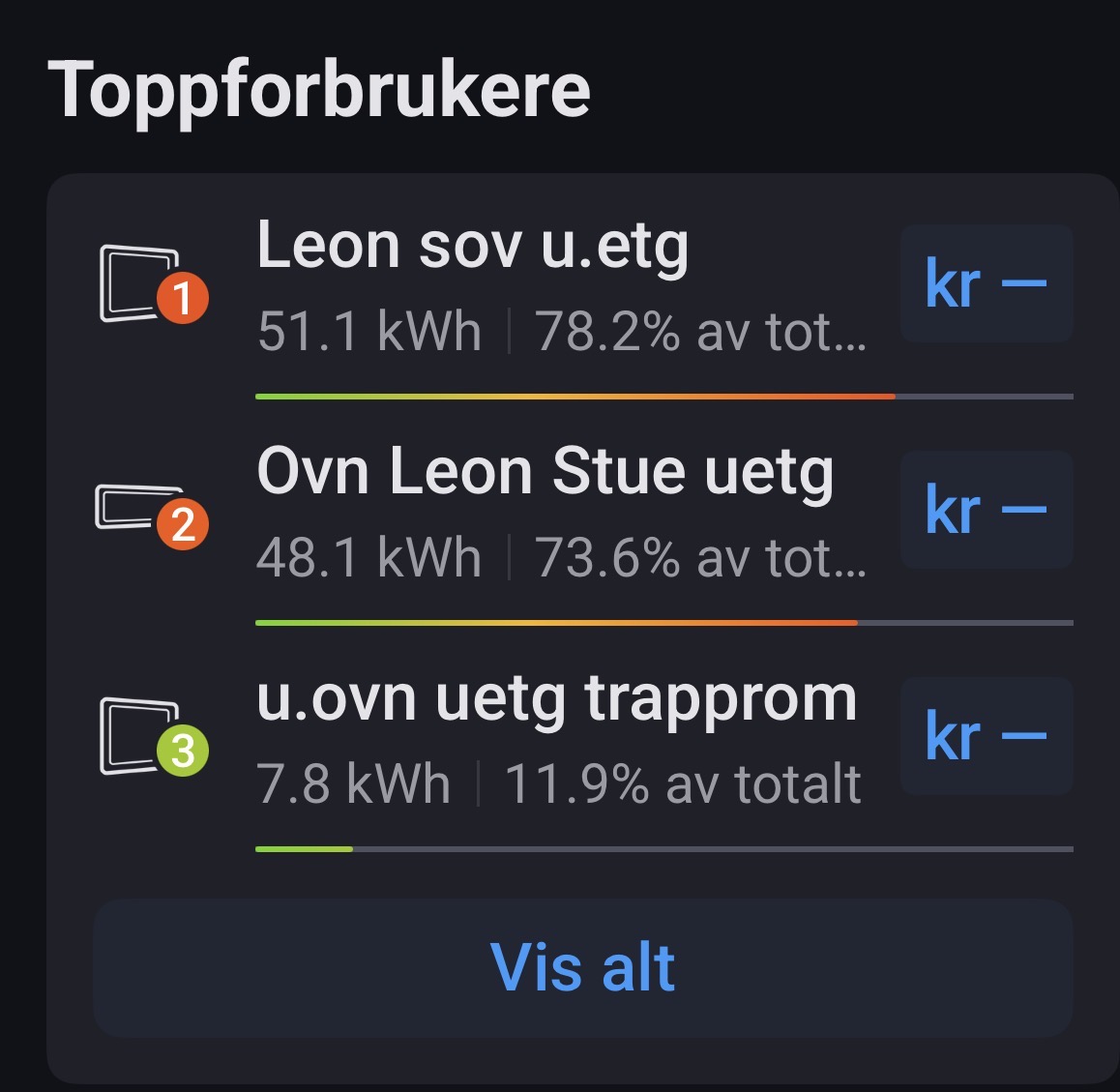

Hi, i have a problem with the energy meter. It shows x10 to high on all the heaters from Mill. Is it posssible to fix this?:slight_smile:
Maybe you can ask it in the Mill Heater topic.
If i am correct. https://community.homey.app/t/app-pro-mill-heating/87777
Waitig for your reply, since this is a functionality Im waiting for.

Alex and Odd Inge, could you either take a look at the code or provide me with more details about the issue you’re experiencing?
