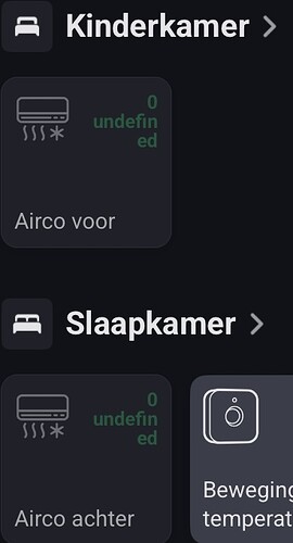

Hi There, specially for @OlivierZal
Since quite some time (don’t know exactly after which update) on our mobiles our 2 Mitsubishi airco’s don’t show the correct temperature value in the devices overview. After opening the device, the proper value is shown.
We have a Homey Pro early 23 with the latest software, app Melcloud version is v42.1.0, both our phones are iPhones running on the latest software. FYI, the web app (Safari MacBook) is shown the right value.
Hopefully it’s easy to solve.
Hi @Peter_van_Poppel,
Since I haven’t updated the app for a while and it works in the device and on the web app, it’s probably related to Homey and not to the app. I cannot reproduce though.
If you enter the device settings, what do you see under “state indicator”, are you able to select the working value? Or every value is broken?
