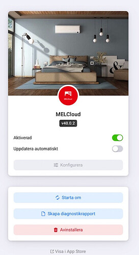

@Kjell_Blomberg, @Marius_Stensrod, @Phil_Bro, can you please download and tell me if it solves the issue?
Installed and runs on lower memory approx. 26MB and its look stable. I run it on both 2019 and 2023. will check back after a couple of ours. Tanks Olivier

Hi The 2019 is still running below 30 Mb, 02,50 it dropped from 27,5 to 25,5 mb and still is. The 2023 Homey is running around 77 mb flat. So it looks like you solved the problem. Good work. what caused the memory leak ?
I’m glad the issue is solved. Difference between Homey 2023 and 2016-2019 memory handling is due to the different node versions running on them, but I confess that it was also an app design issue: when reshaping the energy reports, I forgot one place where I created some useless timeouts – what accumulated memory until saturation.
Hi Olivier, the app version has changed to 40.0.3. After re install 40.0.2 I had no crashes (as far as I can tell). So that might have solved it for me. The 40.0.3 was aiuto updated, referring to the bugfixing, this version is better. Thanks!
