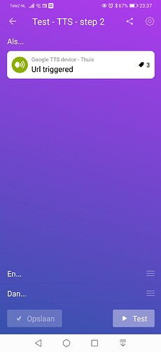

Create another flow and as Trigger, select the Url Triggered from the Google TTS Device.

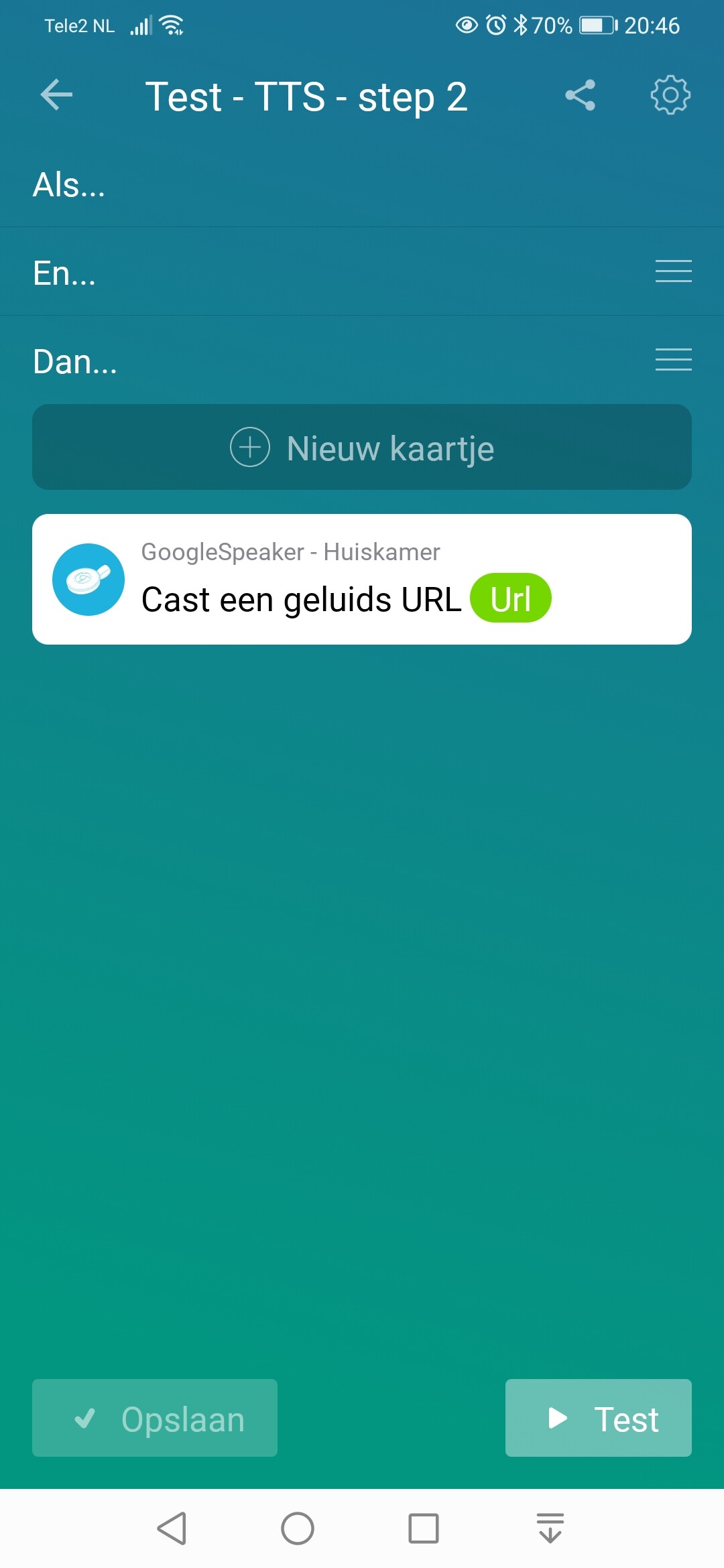

Add a actioncard that sends the Url token from the trigger (available in the flow) to the device you want to play the speech on.
Step 2 of the topicpost.
Can you show me the trigger (the If part) for the flow you just send?
It looks good.

Could you please share your 2 flows.
Why does it look in the Cast a audio URL as if there is a website filled before the tag?
(https://website.com/audio.m) is it a placeholder or a mistake?
Yes,itâs a blank example of Athom ,there is nothing apart the urlđ
It looks the same on mine, itâs just an example, a placeholder from Athom.
