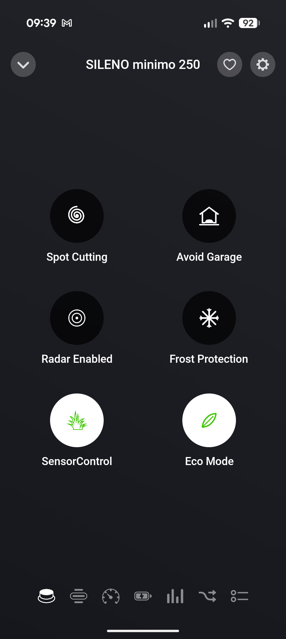

As a summer holiday project I decided to integrate my Gardena Sileno Minimo 250 into Homey. It only has a bluetooth mobile app, and no possibility to connect it to the Gardena cloud. So the official Gardena app does not work for me :frowning:
I hoped integrating would not be too difficult since there were 2 projects on Github that should enable it:
I ended up digging up my old Raspberry Pi Zero W to act as BLE bridge. However, as always :zany_face:, it didn’t work… I had to significantly do more reverse engineering to add fixes and features to AutoMower-BLE. Also I had to make my own, completely different version, for AutoMower-BLE-MQTT. I ended up making my own versions of both (although I hope Alistair will implement my PR’s to his source project).
To make it ‘easy’ for Homey users I created a multi-arch docker image, and spend a lot of time making the installation instructions as bullet proof as possible. But I’m sure you users will manage to find issues :wink: .
Since I have only been able to test it on my own mower I am not sure what works on other Gardena/Husqvarna mowers. Please let me know when you find issues. Also let me know when it just works for you!
Enjoy this fun project!

New version 1.2.0 is ready for testing: https://homey.app/a/com.gruijter.blemower/test/
  • Added set mowing schedule
  • Added reset blade usage
  • Migrated async-mqtt to mqtt
You can now set the weekly mowing schedule from the device settings or from a flow.
DON’T FORGET TO UPDATE YOUR BLE BRIDGE DOCKER AS WELL! Otherwise the new functionality will not work :wink:
