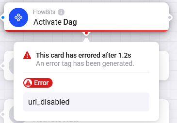

Me again. I think I’ve identified a bug in relation to when notifications to the timeline are disabled.
In that case I’m not able to activate a mode.
I see! I’ll fix it tonight, should be fairly straightforward.
Edit: Fix is live
