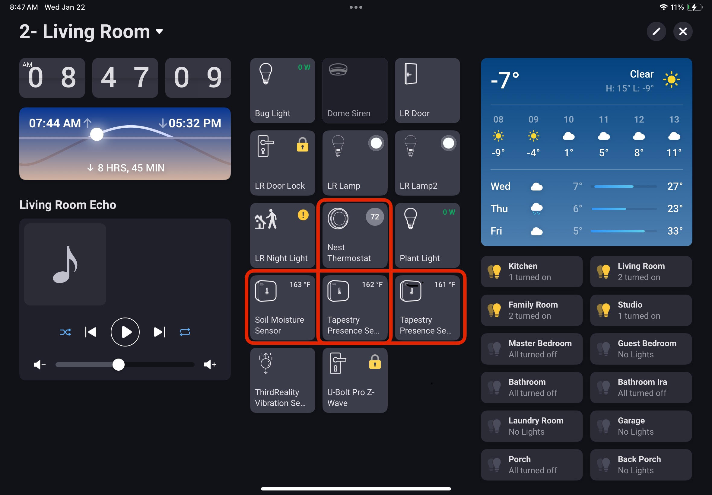

As confirmation of the temperature conversion issue, here is a screenshot of my Living Room dashboard. The nest thermostat is reporting the room temperature at 72 degrees where as the two Tapestry Presence Sensors and the Third Reality Moisture Sensor at an average of 162 degrees:

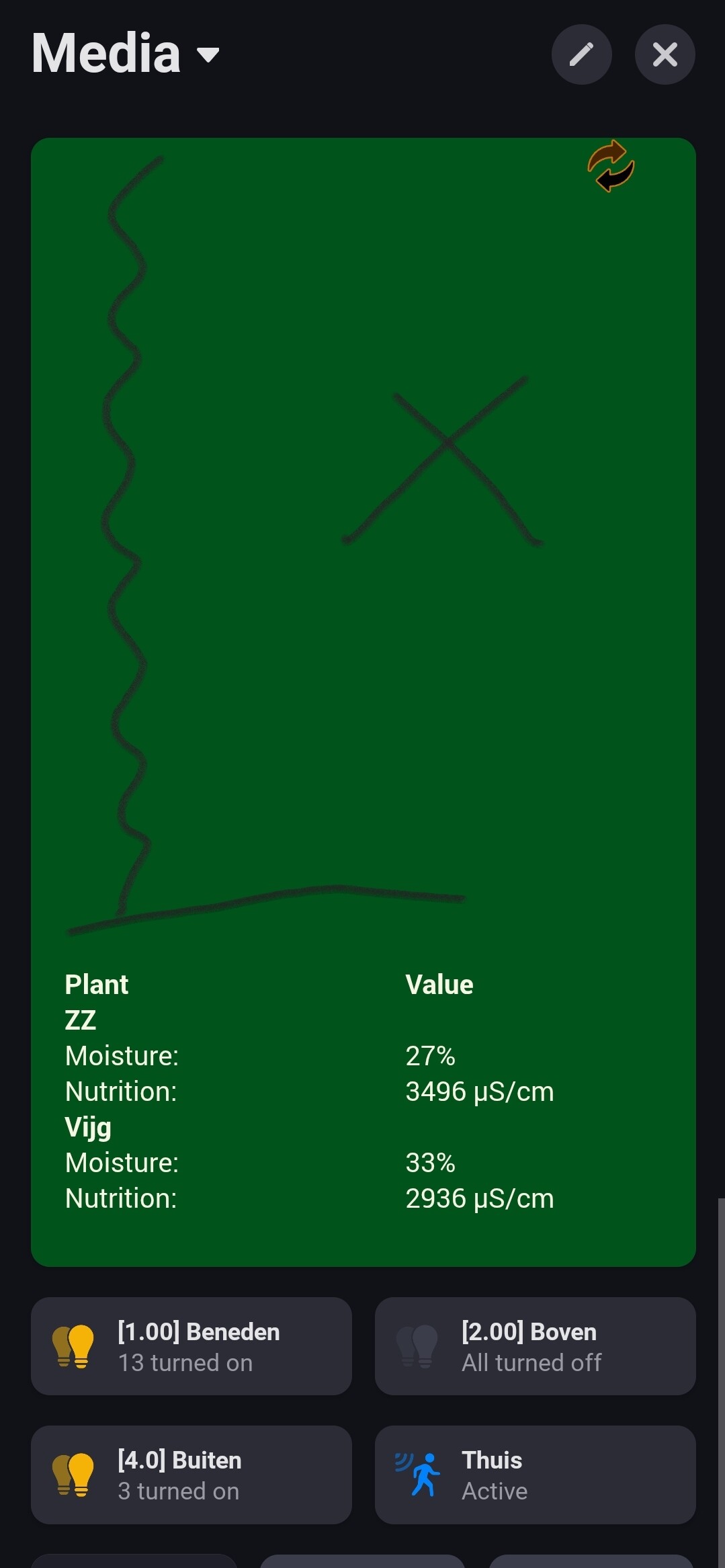

Hi Nils,
I’ve been fiddling with HTML tables and columns.
It works well, but I can’t get rid of the large empty space above the table.
Any hints / ideas?
HTML:
<table style="width:250%">
  <tr>
    <td style="width:50%"><b>Plant</b></td>
    <td><b>Value</b></td>
  </tr>
  <tr>
    <td><b>ZZ</b></td>
  </tr>
  <tr>
    <td>Moisture:</td>
    <td>[Moisture] %</td>
  <tr>
    <td>Nutrition:</td>
    <td>[Conductivity] µS/cm</td>
  </tr>
  <tr>
    <td><b>Vijg</b></td>
  </tr>
  <tr>
    <td>Moisture:</td>
  </tr>
  <tr>
    <td>Nutrition:</td>
  </tr>
</table>
About <table style="width:250%">:
When not declaring width, both columns appear on the left half of the widget.
There’s a bug in the test version. Adrian said he’d have a look at the GitHub history to check the changes. But if you roll back to stable version, the gap disappear, correct?
I have figured out what is causing the big gap, now trying to thing of a way to keep everyone happy :slight_smile:
As a quick fix, just remove all the prettfying (spaces and new lines) so everything is on one line.
<table style="width:250%"><tr><td style="width:50%"><b>Plant</b></td><td><b>Value</b></td></tr><tr><td><b>ZZ</b></td></tr><tr><td>Moisture:</td><td>[Moisture] %</td><tr> <td>Nutrition:</td><td>[Conductivity] µS/cm</td></tr><tr><td><b>Vijg</b></td></tr><tr><td>Moisture:</td><td>[Moisture] %</td></tr><tr><td>Nutrition:</td><td>[Conductivity] µS/cm</td></tr></table>
The change I made was to allow new lines in the text so it could be formatted:
Show this on line one.
And this on line two.
I do that by replacing cr-lf codes with <br> so the status widget displays them. Unfortunately, your pretty HTML has those codes in it and they get converted.
Hello @dooniem
Thanks, reverting to the stable version resulted in my data shown without the gap.
Hello @Adrian_Rockall
Thanks for your quick response.
Oooowwwww, it didn’t occur to me yet to try that code without newlines and spaces in it.
Like this, using one line, it works great in both test and stable versions:
I’m sure the majority of the users will use simple text with newline option.
If HTML (table) code should be on one long line, no problem (for me).
Thanks for your efforts, much appreciated!
