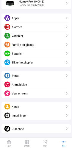

I can’t see the dashboards here by some reason:
I’m on homey firmware 12.2.0 RC3 (experimental) and 9.0.0 app firmware (via TestFlight)
I am on Homey Pro v. 12.1.1.
How do you run Homey on the experimental firmware?
V. 8.4.1 app firmware.
