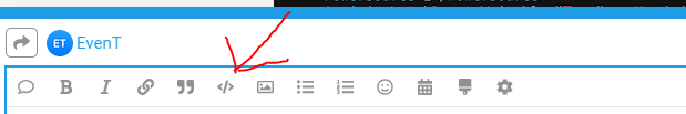

Can you copy it as text?
use the preformated text here in the forum

Thanks for the tip.
