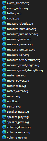

List of icons will be updated shortly:
Coming up: 10 possible Camera’s :slight_smile:
