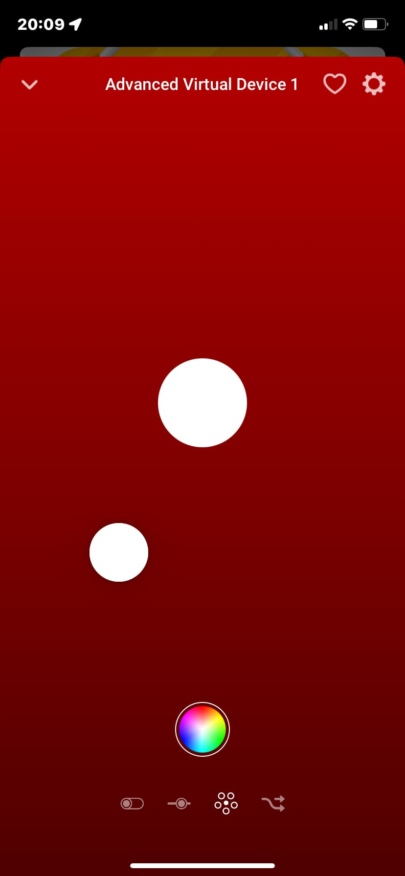

What I mean with that the background is black, that is not presenting the RGB color chosen by app dimmed or not anymore just no color.
And when does it turn black?
Because with mine it keept the color i set it to:
it happens when you are playing with the min and max settings and apply them
Also had the same result on the 2016 model to check if it was nog a 2023 model thing
Ah, well i guess the color that athom/homey gives to the device, is also based on 0-1, so you can perhaps change the min max, but than the device will be in the wrong color.
Not much i can do about that im afraid.
