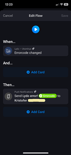

OK, I seem to have found a bug!
I have the following flow that gives me a notification if the error code changes:
However, I get a notification every 10 minutes, which seems to be the same as polling.
It seems that it sends a notification every polling period, even though the error code hasn’t changed since the last time…? Or have I misunderstood something?
I also have the corresponding test flow for Activity, Inactive reason, Mode, Next start and State. But they don’t trigger every 10 minutes. It is only the Error code flow that behaves as it does.
That is not ideal and not how it should work. I did not have that issue myself but i will make more tests (uninstall, reinstall 1.2.1, add device and a flow, upgrade to 1.3.0 test). Can somebody else upgrading from 1.2.1 to 1.3.0 (test) confirm if they had to reinstall the device?
Strange. It should only trigger when the errorcode change. I tried this on my end and only got the trigger the first time.

Hi @Krisstenswe, i have made more tests on my side both with my mower and with a mock/simulator and i get the code only the first poll it changed. In your example you seem to get ‘null’ as the errorcode which seem strange, it should return 0 when no error. Do you ever see the errorcode number there?
If you have time could you remove the device, re-add it, set the polling to 1min and maybe recreate the flow with the error trigger. Then trigger an error on the mower to see what happens?
