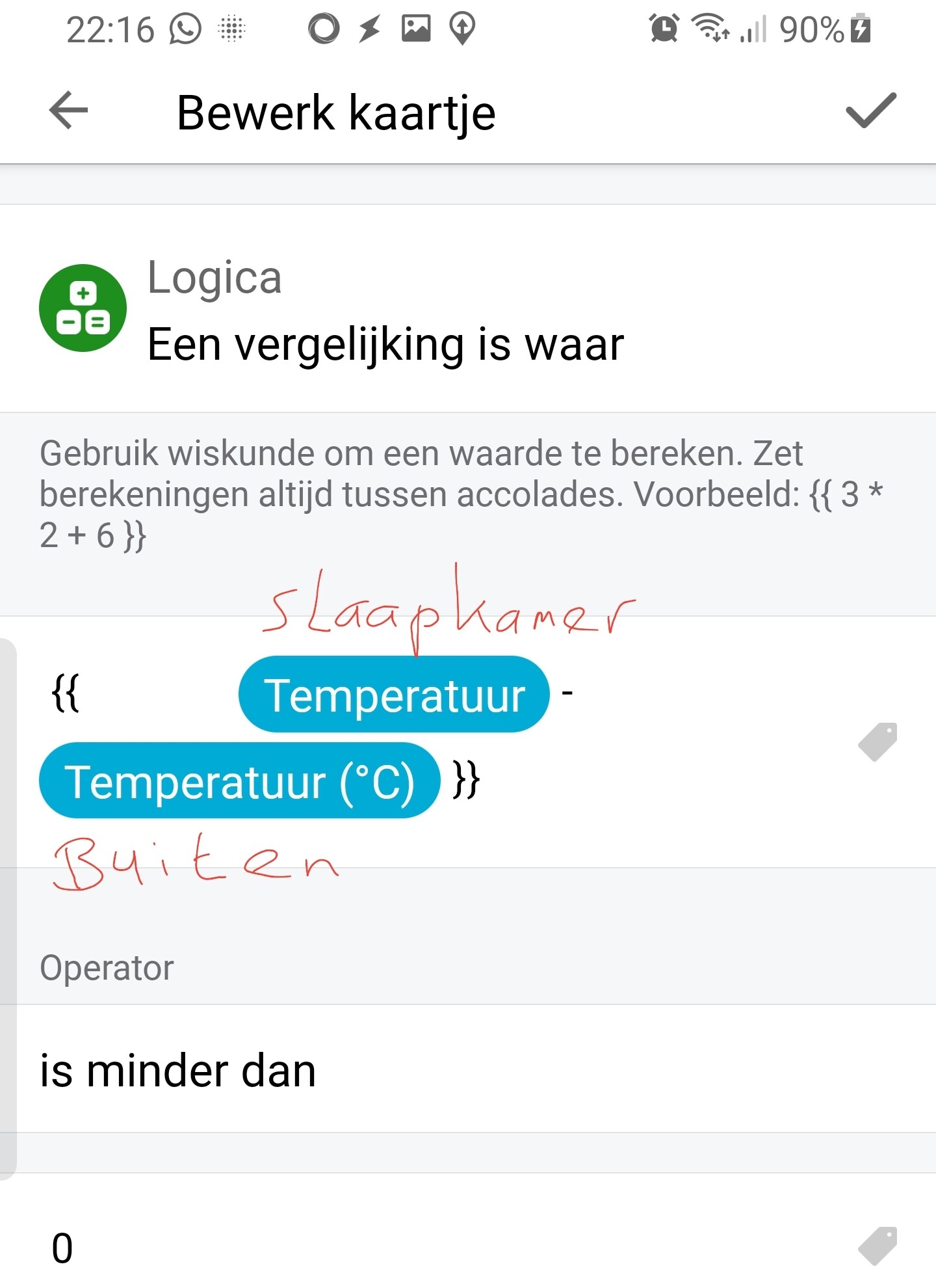

The delta’s can be calculated using logics math.js like said before.
Example:
(“temperatuur is veranderd” means “temperature has changed”)
Logics condition card (the And card) “A comparison is true”:
