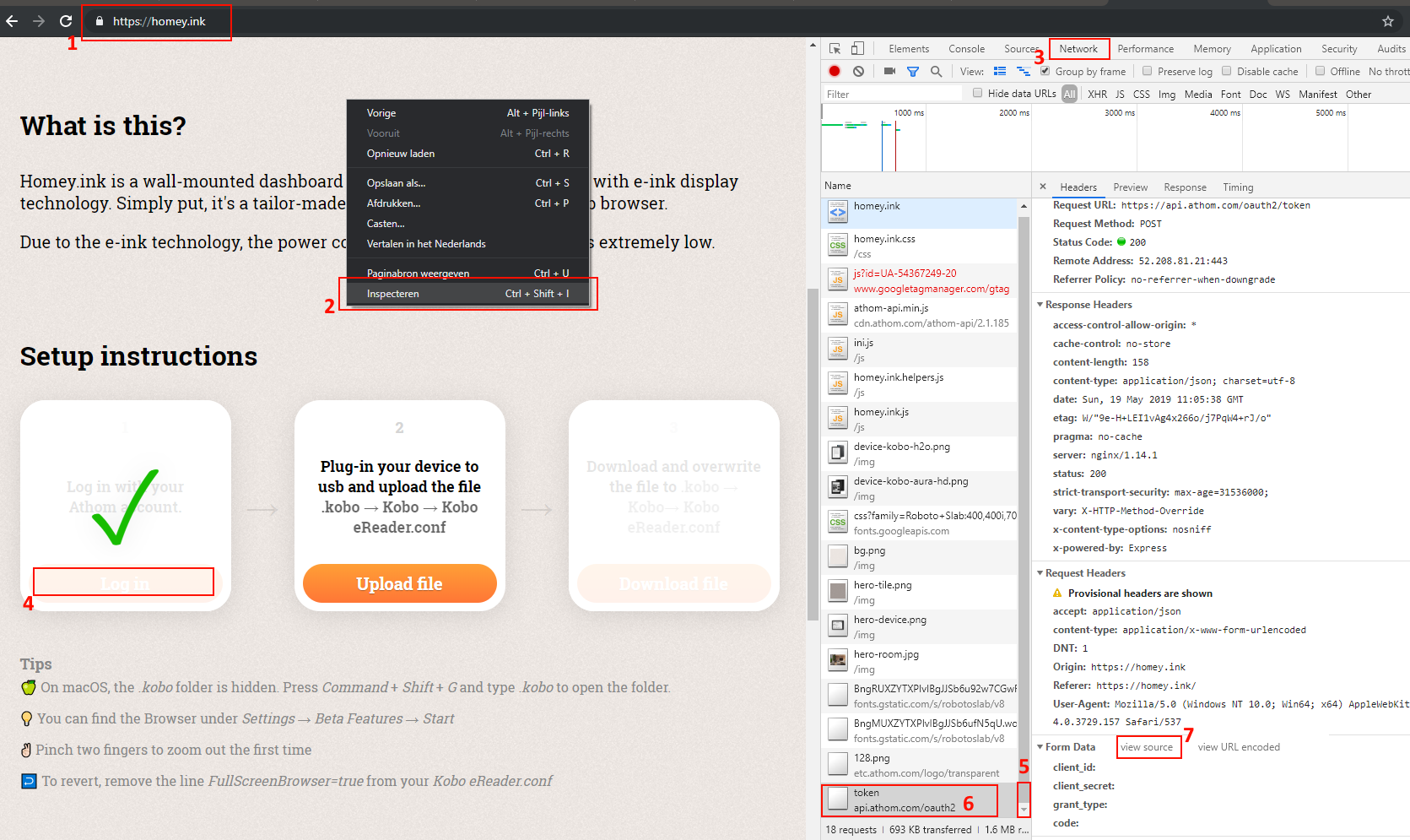

I have no idea how to authenticate local, Using the homey.ink procedure i was able to authenticate on cloud and use all the API’s. As i had trouble finding the needed info here, here is my contribution. Hope this is helpful to someone.
Getting a unlimited key
First step is to get a token that is reusable (longer then 24 Hours), because the API bearer token is only usable for 24 hours and we don’t want to change our code every 24 hours. homey.ink is our solution as it generates a key without an expiration date.
Here we go:
Step 1: Go to https://homey.ink using google chrome.
Step 2: Right click on the page and select inspect(inspecteren) or use Ctrl + Shift + I
Step 3: Select the Network Tab (this will show the network traffic after the authentication is done)
Step 4: Use the “Log In” button and follow the authentication steps.
Step 5: Use the scrollbar if needed, (If you followed this step by step you’ll probably only see one item)
Step 6: select the item named “token, api.athom.com/oauth2”
Step 7: In the headers view scroll down to Form Data, and select the “view source” button.
Step 8: below the “View Source” button the needed key will be shown. Copy it . We’ll need it for the API authentication. it will look something like this:
client_id=09ab2b247cdff0918abfd00d&client_secret=l159fjann0173h2jllsppehg2vj4l28dhhakl3010&grant_type=authorization_code&code=09ab2b247cdff0918abfd00d47cdff0918a2b2414
P.S. This is just an example. your key will look a bit different.
