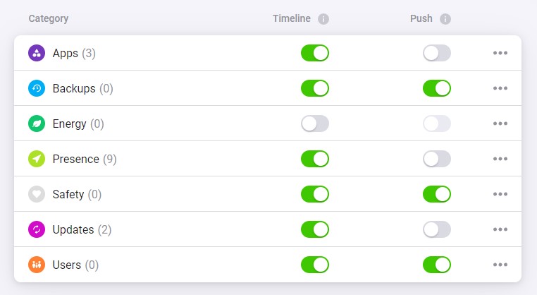

First of all, thanks for the app, glad to see I can access my Landroid within brand new HomeyPro :slight_smile: (new user here).
A question though. When I open the Homey app on my phone, the Timeline on the home page is totally ‘flooded’ with battery notifications from the Landroid. It of course makes sense that the mower battery fluctuates hugely, that’s simply how the device functions, recharging at the base station everytime, just like a robovac.
Is there a way to exclude the Landroid from sending notifications to the Timeline? Since they are unnecessary for this kind of device.
The only way I discovered to stop the Timeline being flooded by Landroid notifications, is by disabling the Energy notifications altogether. But that means I won’t get any useful Timeline notifications from any other devices either…
How could I solve this?
They should not appear on your device timeline. Have seen it once before, but that seemed to be an Athom error, not an app thing could you do a restart of your Homey and see if the problem persists
Hey Martin,
I restarted the Homey and turned on the Energy updates in the Homey Timeline Settings to see what would happen.
And unfortunately the Landroid started reporting it’s battery status to the Homey Timeline again.
Okay. I see what is happening. Will fix.
Awesome!

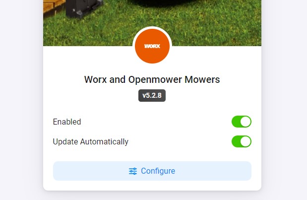

5.2.8 dont work here to my worx mower.
5.3.2 should revert the mqtt V2 change
Did the change work for you people? then i can submit to live.
I don’t know what I should be looking for (if anything) :slightly_smiling_face: my app is at 5.2.8, and the mower is still reporting its battery status to the Homey Timeline. No idea of that’s for the app to decide, or just a core Homey feature. Maybe Homey should make it possible to exclude certain devices if desired?
Screenshot 2023-10-06 125839
Screenshot 2023-10-06 130034
There is a LOT going on in the log though, is it supposed to be that busy? Also, there may be a problem with the ‘Copy Log to Clipboard’ function.
It’s working for me like before, mower is reachable and app is not crashing ( 5.3.2 ).
Thank you Martin for quick fix !
Hello Martin,
Are you still planning to change the battery reporting, or is this something only Athom could do?
If not, I think I’ll turn it off again for all devices. It’s a bit much in the Timeline :slightly_smiling_face:.
(on version 5.3.2 now)
This seems to be tightly linked with measure battery capability. I cannot turn off this because of that.
Strange thing is that I do not experience this behaviour, it just reports once for low and when battery is on level once again around the mowing work.
Okay, so it is not possible to have an option in the app settings like… “report battery status to Homey yes/no” :thinking:?
My mower goes out to mow twice a day, so that doubles the amount of timeline notifications :slightly_smiling_face:.
