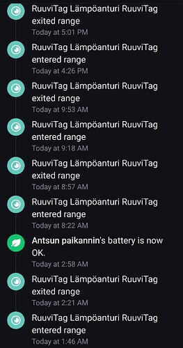

Hi. Is it common that Ruuvitag keeps dropping out all the time? My tag is only around 2,5 meters away from the Homey hub, behind one wooden wall. I tried also another position, but same thing happened.
It happened to me sometimes when I didnāt have a ruuvi gateway. In the device parameters you can increase the number of attempts before marking the device as off, or you can disable notifications for this device
Well, I am not worried about the notifications, but when the connection is down for several hours or even days, there is no data available. It is a matter or reliability which I am disappointed in.
