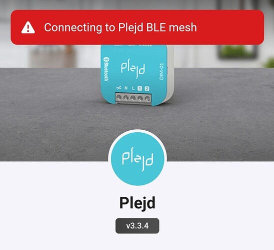

Hi, my model id is homey5q and whenever a flow is triggered to turn on lights the closest light which is about 2 meters from the homey gets turned on, but none of the other lights and in the homey app connection to all Plejd devices is lost with a exclamation mark and the message “connecting to Plejd ble mesh”
Triggering different lights manually from homey they all work
Hi, same issue herre. Upgraded to Homey 2023 yesterday and got problems with my kitchen lights (three different light). If I try to turn on everyone at once with a flow the plejd app seems to reset the Bluetooth connection, and all plejd gadgets are frozen until the reset is complete. Found a workaround delaying the different lights with one second. Any ideas why this happens and are there any solutions out there?
doesn’t work for me either :confused:
Same problem for me when switching more than one plejd unit. Bluetooth connection is lost. If I add a 3 s delay it manages two units then crashes at the third. I’m using Homey Pro 2023 model.

Cant get it work, got it synced/added but then red triangle and message: "“Device unavailable - Connecting to Plejd BLE mesh”.
Have another BLE (end)device attached direct to HP23 (Switchboot curtain robot - or what it called), so BLE seems to work.
I might missing any hardware here?

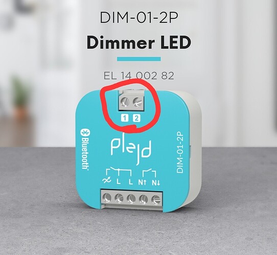

Hi! I am super happy with the app, and I already love it :heart_eyes: But i am wondering if it is possible to add flow card for the input signal 1 and 2. Like “when input ‘#’ gets a signal” :thinking: Only that would be fantastic :star_struck:but if it was also possible with dobbel click and maybe even scenario that would be awesome also :grinning:
That would indeed be awesome, there while be so much more possible than.

I have a feature request which I’ve seen others also posting about:
  • It would be very nice to support double press functionality to buttons since they already have support for that. That way, I could use my Plejd buttons for more than just controlling the lights they’re paired to. E.g. turning off all the lights in a room (also those who aren’t Plejd devices). As long as the double press functionality is reachable through flows, there’s no limit to how functional this addition would be.
