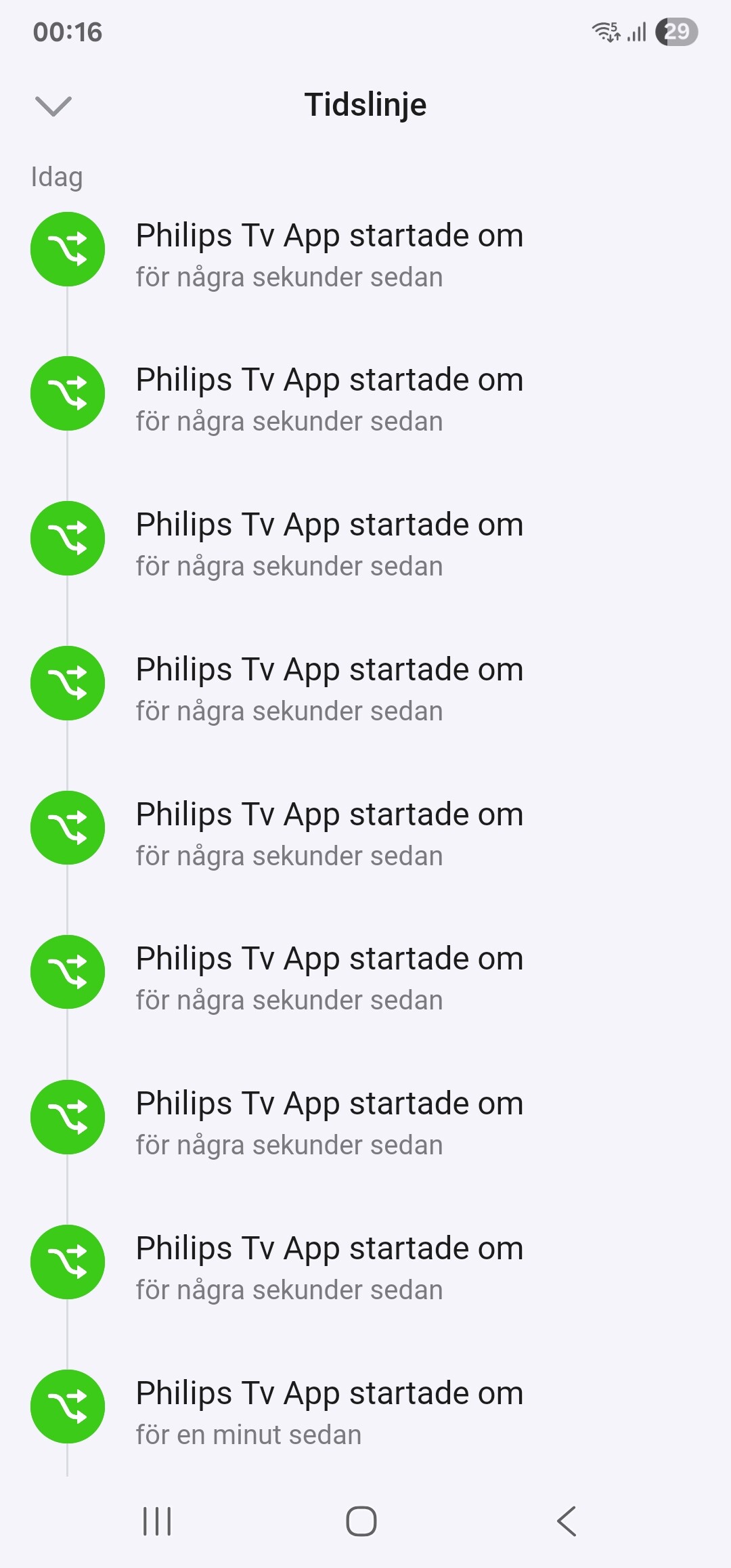

Today the app crashed multiple times and then Homey crashed, it used 8.1GB of Ram (I have a bigger Pi in my Homey Pro), removed the app and restarted Homey, now it only use 1.3GB Ram. Something isn’t right.
same here, but I think @lucasvdh does not have the time anymore to maintain this
