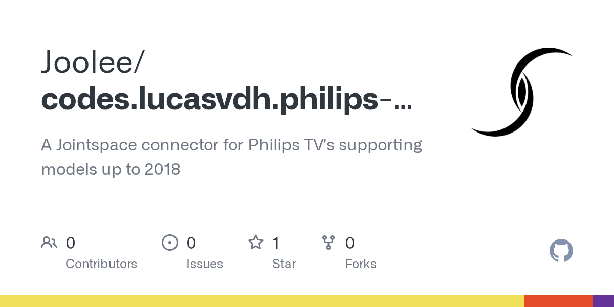

How to install
- Either install git and use
git clone https://github.com/Joolee/codes.lucasvdh.philips-jointspace.gitor download and unzip from: https://github.com/Joolee/codes.lucasvdh.philips-jointspace/archive/refs/heads/beta.zip - Follow step 1 from: Getting Started | Homey Apps SDK (You don’t need to install the Docker cloud stuff)
- Run (You need to have a console started and cd’d to the directory containing the app.js file)
npm installhomey loginhomey select
- Run the app with
homey app run. Or install permanently withhomey app install
