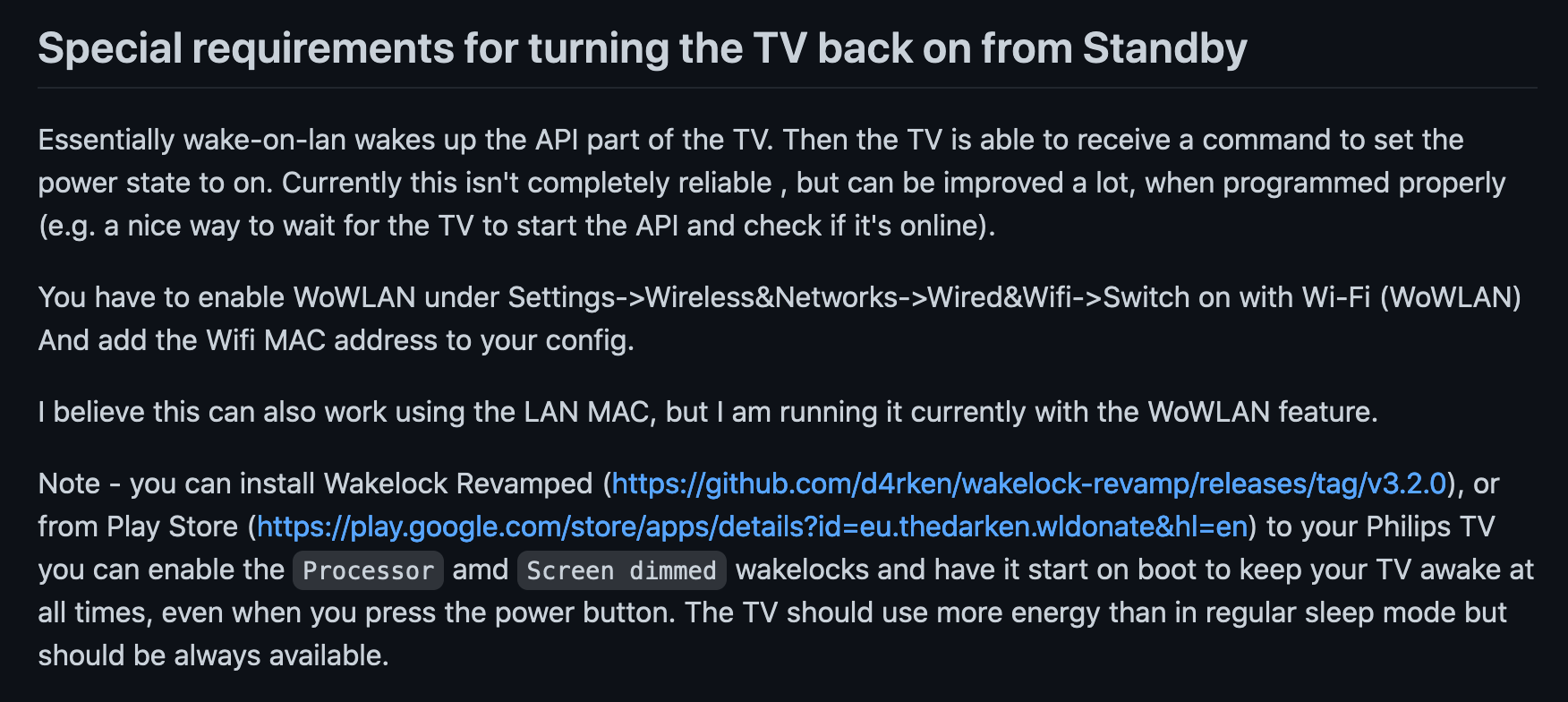

FYI:
I use a different work-around to keep my tv on.
Installed Wakelock Revamp (installed the mobile version via apk) and enabled the processor option. This keeps the tv in standby but reachable via network and also ADB.
With this option you can also wake it up with Chromecast.
Thanks for the suggestion, I’ll try this next.
Reinstalling the Chromecast app did not result in the TV staying on for me.
i also tried that trick with chromecast but didn’t work for me either.
I can confirm that this solution works for me, thanks @martijnpoppen!
I’m going to suggest the Wakelock Revamp app as the main solution to the power on/sleep issue.
Sadly this means that there’s no solution for non-Android TV’s yet and I don’t think we’re going to find one. If any new information surfaces I will reopen the issue.
If, like me, you’re not able to connect to your TV via adb or you don’t know how to: you can install the app from a USB drive (download from Github) using a file manager app on your TV to open the .apk file.
I saw that for HomeAssistant they’re suggesting the same thing (link: GitHub - nstrelow/ha_philips_android_tv: Home Assistant custom component for the newer (2016+) Philips Android TVs)
I got this idea from the Home assistant community. Where they where discussing this issue. I think there’s no other way as Phillips completely shuts-down.
Some extra info from the HA integration:
