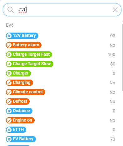

You are using a text variable for the slow and fast charge target.
For an example on my Ev6, the charge target is stored as “80” but in text-variable. It should be handled as a numercal value to be of use.
Can you please fix :slightly_smiling_face:
homey Kia app variables

That is an ENUM, so it will be presented as string (text). But most flow dont have an issue using a string as number. Or you could try something like {{ Number(target) }}

I managed to use honey script and convert it to a number. In flows I could not use it as a tag for easy charging app to set target charge.

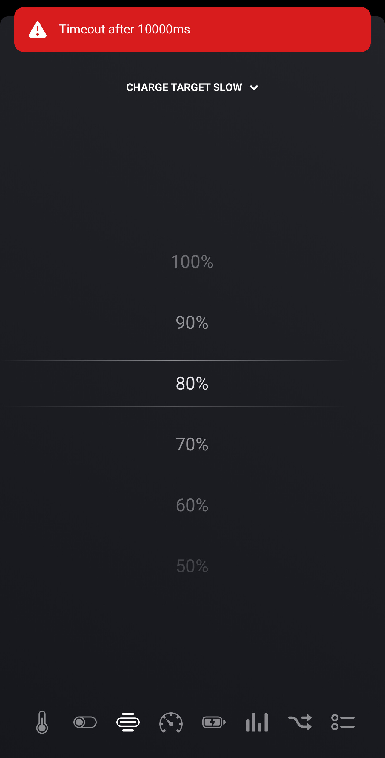

Trying the experimental version to force EV for 2024 Kona.
Charge level is set to 80%, but not possible to update. Times out.
63fba924-f6f5-4579-879c-1c2f6f0cb5f1
@Gruijter
Not much I can do at the moment. I need a newer NodeJS version on Homey to be able to update the kia/hyundai library I use. HP2024 has the right NodeJS version, but HP2016/2019 does not. That needs to be fixed first in a Homey firmware upgrade. It is unclear when (if?) this will be implemented by Athom.
