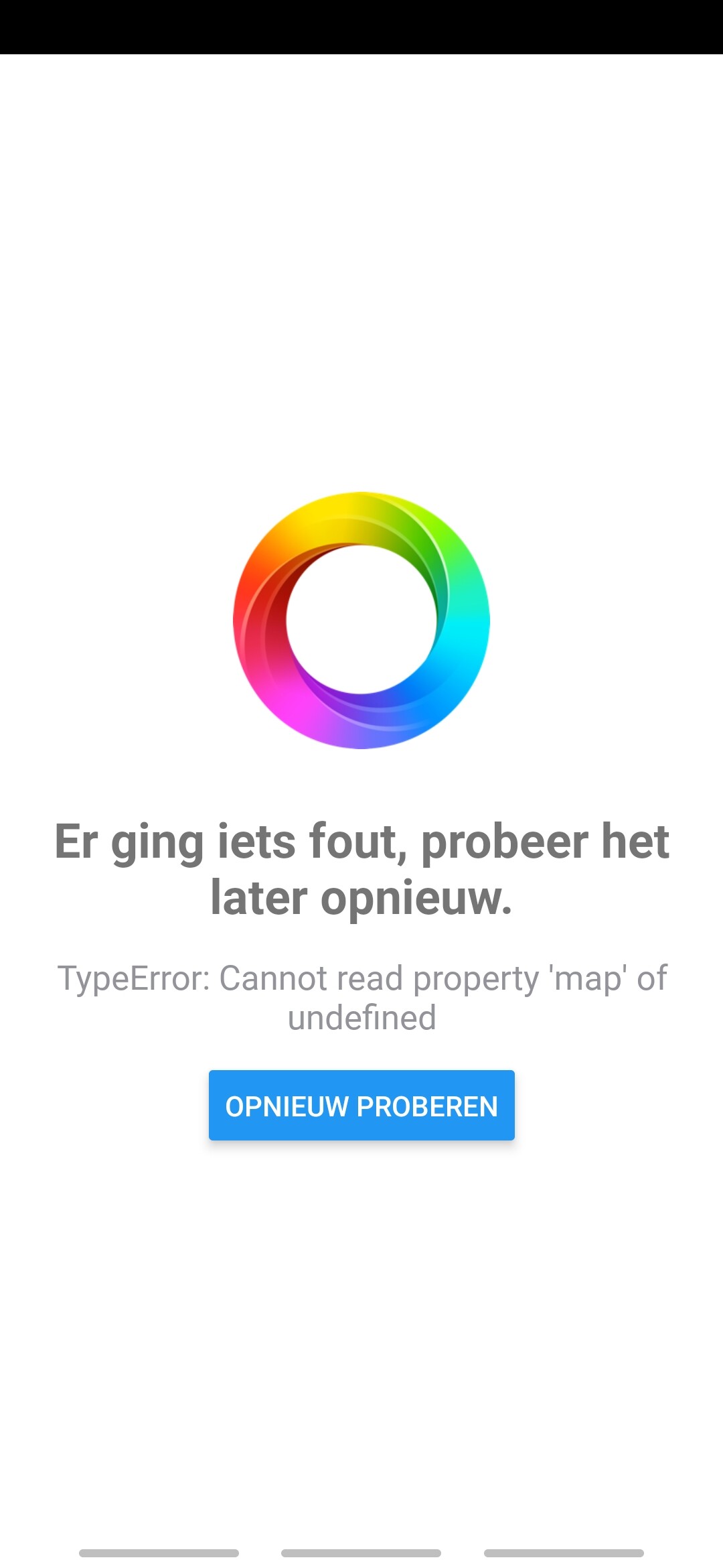

When I try to read the % of the 12-v battery I get an error: cannot read property ‘map’ of undefined.
can you pls restart the app, and then after 1 minute create an app diagnostics report?

@Jacques_Heijnders Your 12V battery reports a SoC larger then 100:
"battery": {
      "batSoc": 255,
      "batState": 1

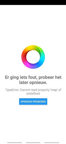

When/where do you see the cannot read property ‘map’ of undefined error exactly? Is that in the mobile app?
On my iPad when I want to read the % of the small accu.
Reading out the battery is no problem
Groeten,
Jacques Heijnders
Groeten,
Jacques Heijnders
Yeah, I think that Homey chokes because a battery % over 100 should not be possible (so a Homey/mobile app error). I can cap the value from the app in a next version.
Question is: why does your car report a Soc of 255? Seems like a problem with your car actually…
