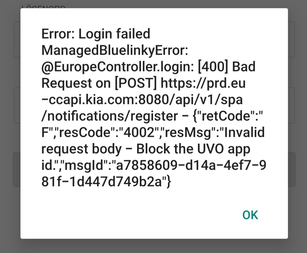

Kia connect works. It say in my app log Invalid request body. Block the UVO app id. What ever that means.
I have just installed the Kia and Hyundai device in Home Assistant. Here, too, it is no longer possible to connect. Despite entering the correct user, password and PIN, the setup stops immediately.
So we can assume that Kia has tampered with its api again so that all third-party providers are excluded. :face_vomiting:
Did a little reading on forums. Turns out Kia have scraped the old UVO app and completly replaced it with Kia Connect. Looks like the API changed as a result. Im guesig here a litle based on the error. Well is a question at the same time. The error im getting looks like the app is using the app id the old UVO app used am i right? Considering the server is responding the way it does could it be activly blocked sins they scraped the old UVO app?
Github thread HA:
A possible fix is in the works. The problem is related to Kia/Hyunday switching to their new iOS/Android app.
The community is working hard on a fix and progress is being made. I have good hopes I will be able to publish a working version within a few days (but no guarantees :grimacing:)
Many thanks to all the community developers that have again successfully reverse engineered the changes Kia/Hyundai EU made to their API! A new version of Bluelinky was published at 1am this morning, and I got up early to implement it in Homey :slight_smile:
New version 2.9.8 available as test: Kia and Hyundai App for Homey | Homey
I was only able to test it with my own Kia, but I am confident it also works for Hyundai.
