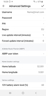

I requested (and received) an app API key from ABRP. With that I managed to get ABRP support integrated in the Homey app. You only need to supply your car / user key that can be obtained for free in the ABPR app.
The integration works good for me :hugs:. Just a pity that the ABRP is not compatible with android auto. Now I have to navigate on my phone screen when using ABRP.

For its calculations ABRP uses a fixed average consumption number (my e-niro is around 170 wH/km @ 110km/h). To use real consumption figures in ABRP, you can install a connected dongle in your car that does live uploads of the SoC (state of charge), speed and location of the car.
Now with my Homey app, you don’t need to install a dongle + SIM. Homey will get the live data for you from the car, and acts as a bridge to upload it live to ABRP. Note that if you don’t want to upload any data to ABRP, just don’t enter your car user-key in Homey.
So adding it in my Homey app is just a small gift to all future users. And it’s all for free! :sunglasses:

Besides a lot of stability improvements and fixes, it is now possible to automatically start getting live data from the car as soon as your phone connects to the car’s bluetooth.
Force live status updates when your phone connects to the car’s Bluetooth
For Android and iOS there are apps that automatically trigger Homey to start getting live updates as soon as your phone connects to the car’s Bluetooth. In the automation script you need to open the following web-page (HTTP GET):
https://<your Homey cloudid>.connect.athom.com/api/app/com.gruijter.hyundai_kia/live?secret=<your secret>
There are multiple apps that can do this. For Android have a look at automate and adapt this flow to match your own car’s Bluetooth, your Homey cloudId and secret (search for Homey in the community flows). For iOS have a look at shortcuts.

Installed Homey 5 beta today just to be able to install and use your app with my Kia Niro EV. I have everything working now, but I had a lot of trouble to actually “pair” the car with Homey.
I used the correct username and password but still got an message telling me that the credentials was wrong. I looked in your apps log and it told me that username/password was OK but after that it got “Bad Gateway”. I experimented a lot and found that if I use another device (my iPad) to logon on using the Kia UVO app and then directly loged out again, after that procedure my credentials was accepted by your app. But then I got stuck on the PIN…exactly the same thing with a log message telling me that PIN was OK and after that “Bad Gateway”…
I tested the same strategy, logged on on my iPad using Kia UVO app, forced an update so I got prompted for PIN and then I logged out, and guess what…my PIN worked in your app and my car was available as a device in homey…and from there everything seems to work as expected and I really LIKE what I see!!
Thx 4 the feedback! What region (country) are you in?
