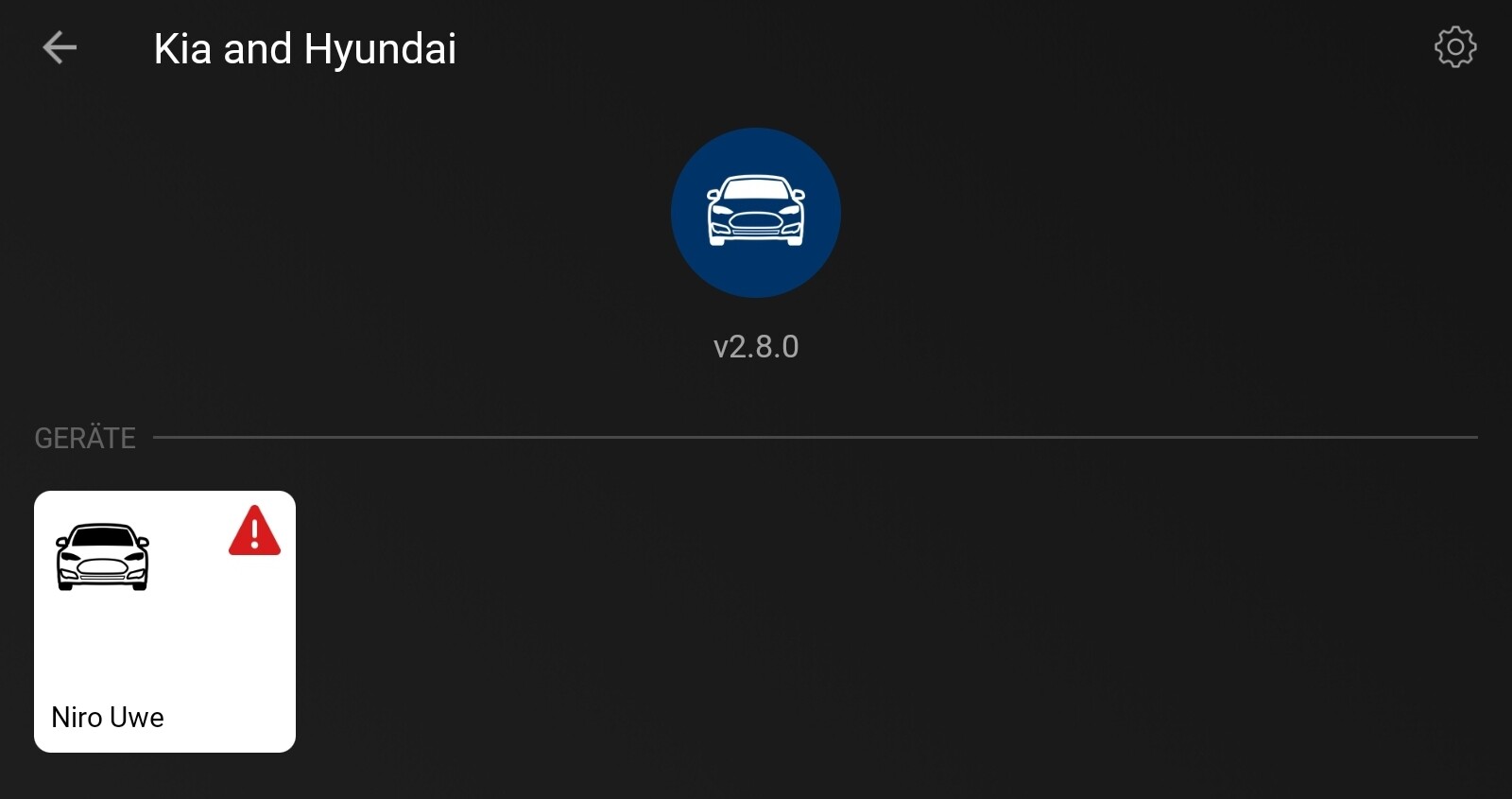

KIA seems to be messing with the server again. Since noon today, Homey can no longer reach my vehicle. I get an immediate connection via the UVO app. Does anyone else have this problem?
Just did a refresh from Homey and that worked fine (Kia)
Homey Restart, no success
Homey PTP, no success
The vehicle is accessible for about 2 minutes and then goes back to error.
I have not made any changes to the setting
Does this help ?

Actually that does suggest a server or network issue. Maybe only in Germany there is an issue?
Edit: I now also have troubles connecting :face_with_raised_eyebrow:
Edit 2: but the official Kia app is also down. So it is server related.
At the moment it works again for me !
Same here :partying_face:
