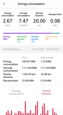

There seems to be more nice information in the new UVO app:

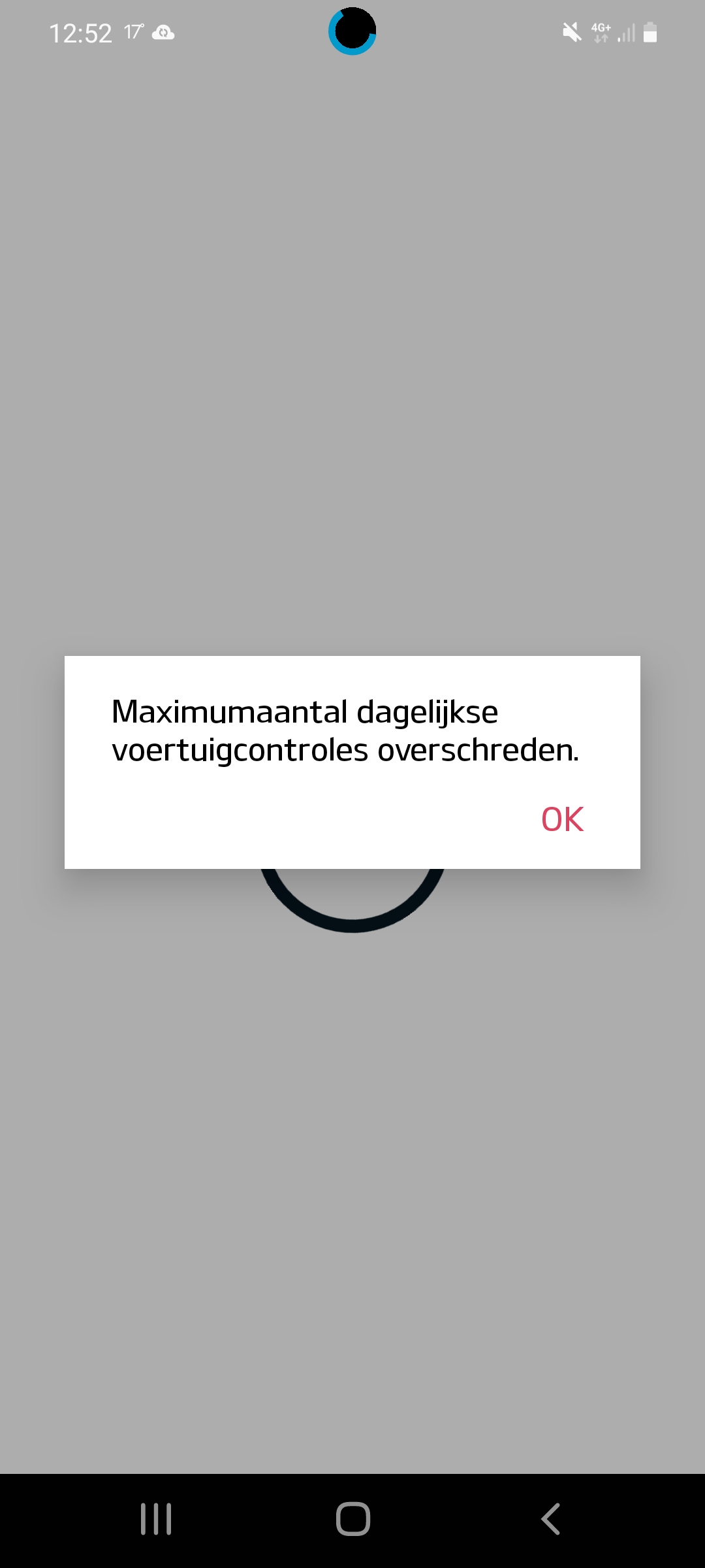

I think Hyundai/Kia were migrating their servers yesterday. I had ‘too many api calls’ yesterday even though I used it the same as every day.
Was the same with me. I almost suspect that I am blocked again today due to the many calls.
Is there perhaps some adjustment in terms of the number of times though? Haven’t done anything special yet and have already been blocked for today😵
I hope not… but that could be the case. I’m still good with server poll every 5 minutes, but I started polling at 8 this morning.
Looks like im hitting the limit also. I had it working this morning and when i checked around 15:00 it had reached the max limit for today.

I had mine set at 15 min interval today, and it stopped working just now (22.45). So that means the limit is now 100 status requests per day :frowning:
So a max of 1 poll per 20 minutes average to make it through the entire day.
