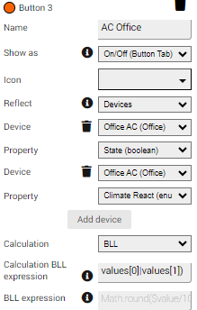

Here another one: I would like the OR function (in BLL) applied to a device with boolean property and a device with an enum property.
I tried values[0] OR values[1] and or(value[0],values[1]) and values[0]|values[1] but it did not work.
@Rrrr
What you have in this image is correct, except for the ending )
Edit: sorry, i thought 2 booleans.
Well, you can do something like this:
$values[0] || $values[1]=='enumvalue'
Change enumvalue to what should evaluate as true.
The enumvalue is either on or off.
$values[0] | $values[1]==‘on’ does not work for me unfortunately.
{{$values[0] | $values[1]==‘on’}} same.
Try
$values[0] | ($values[1]=='on')
And watch those quotes, the need to be these quotes, not the formatted one’s.
It what I tried in trial and error. The new suggestion does not work either.
$values[0] works, just not the second part. How can I troubleshoot the expression?
Try ‘true’ instead of ‘on’?
No luck
