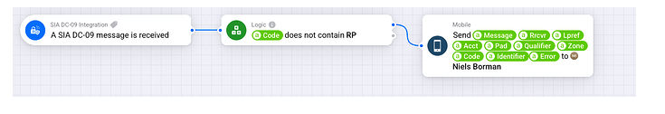

If the doorbell sends a sia message please make a flow for me as below and send me a screenshot of the message received on a doorbell message.

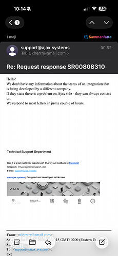

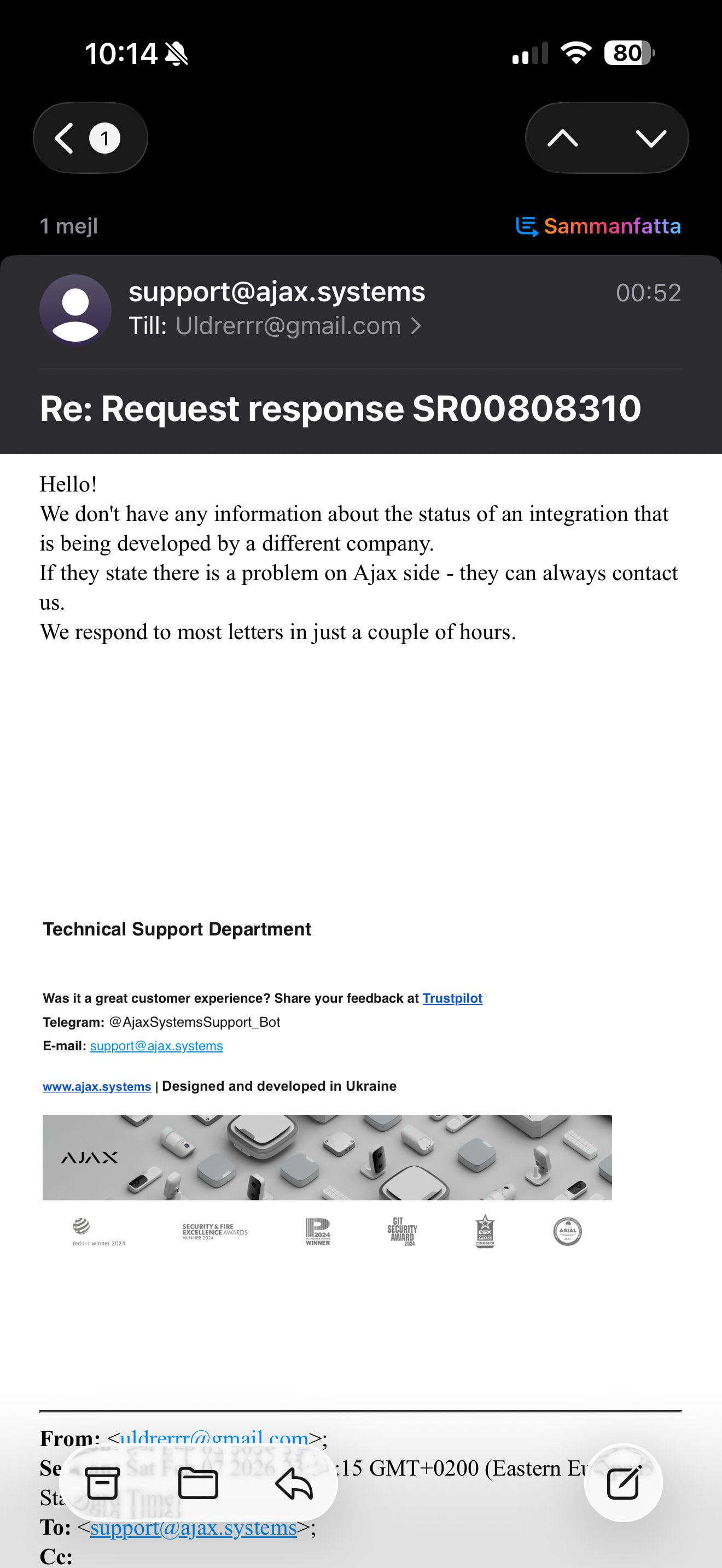

There is plenty of others with integration aswell. Akuvox for example. Looks like its just not a priority for homey.
According to ajax there’s no info regarding homey pro integration with Ajax.
