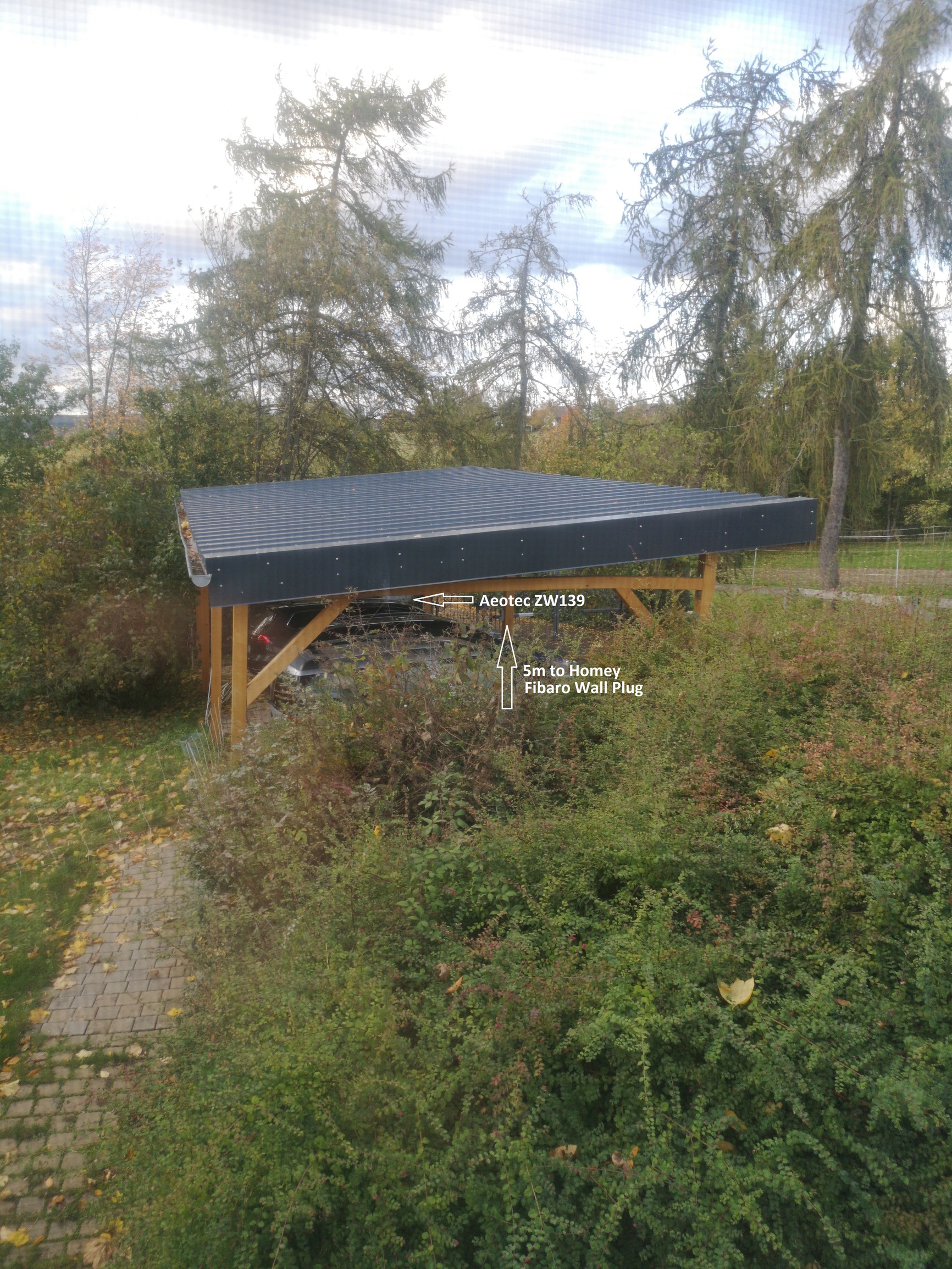

Hello, I have a problem with a relais. When it’s next to Homey it can connect and I can control it.
But on its target position, it won’t connect. The distance is only about 7m.
For testing I’ve now plugged in a Fibaro wall plug. That is working fine. But why it will not be used as repeater/mesh?
 ![z-wave](https://us1.discourse-cdn.com/flex025/uploads/athom/original/3X/1/1/115a6f707648b1f59714a18dde9dcfdf6c272524.jpeg)
Node 2 is the socket
Node 24 is the relais
 ![z-wave2](https://us1.discourse-cdn.com/flex025/uploads/athom/original/3X/4/9/49e6f150836ccfa8b891a2788814e075c97952d2.png)

no z-wave device update it’s internal table of which devices are nearby on its own, that is why it has a heal button (when you click the 3 dots), so try that (on both devices), and wait a few minutes, and try again

Thank you! I’d tried this before, without success. But now it helped and the relais is working!
