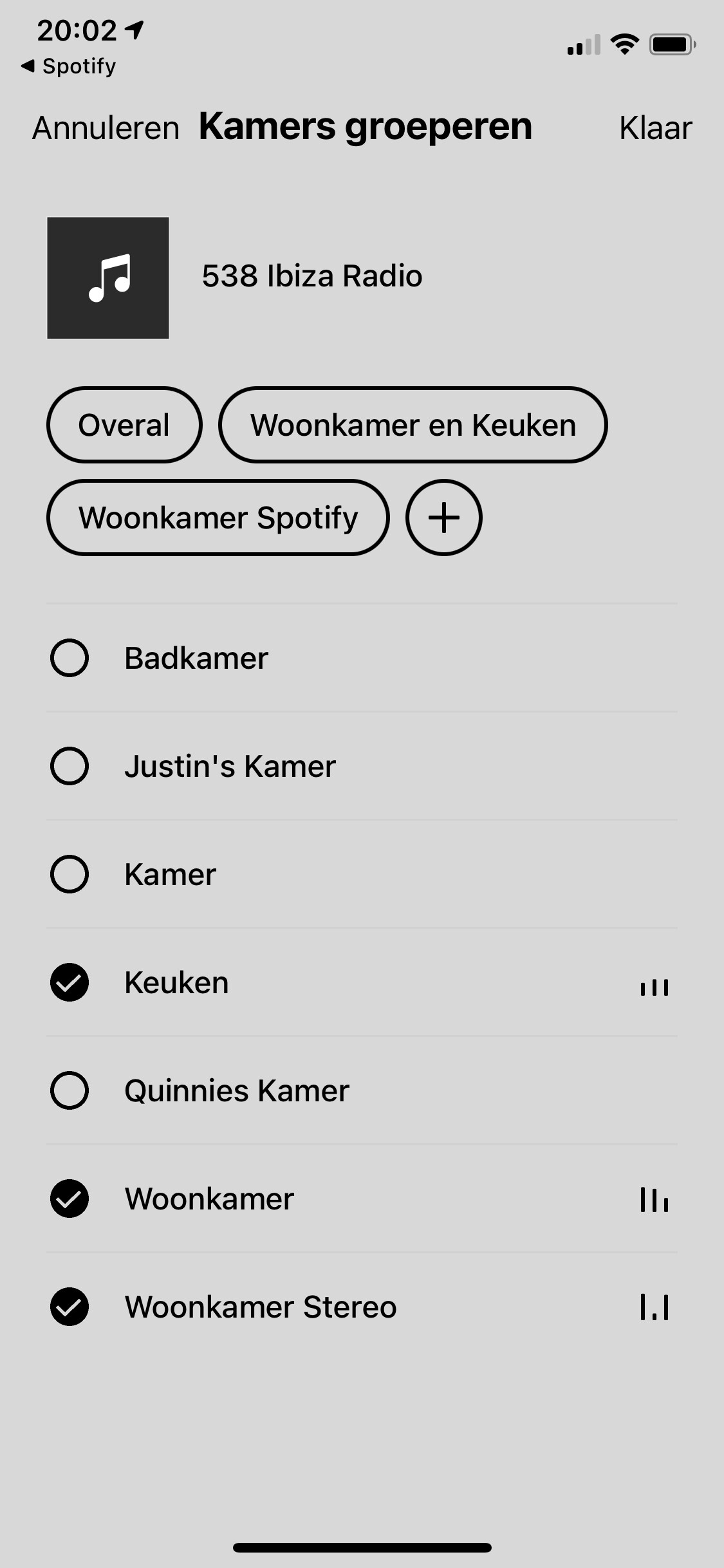

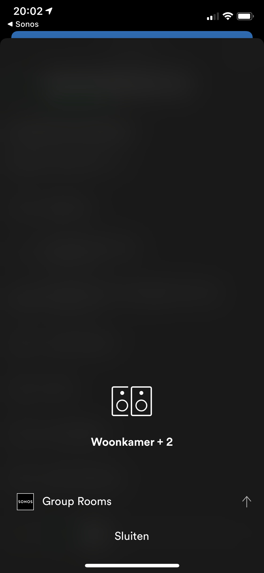

I assume you start spotify with the spotify app, in that case there is also the possibility to choose your room, choose to group room and choose a presetted room. In this case i made 1 room named woonkamer spotify, which only has 1 device
 ![image](https://us1.discourse-cdn.com/flex025/uploads/athom/original/3X/e/6/e601f7fc1b9fa66531007ad4a05c306d9e0c1074.jpeg)

> [@Marcel\_Ubels](#):
This for sure is an option. I’d love to see it working without having to instruct my users (wife + kids). I indeed am using the spotify / sonos.
I’ll look into it when I have time, thanks very much for your help and idea’s.
