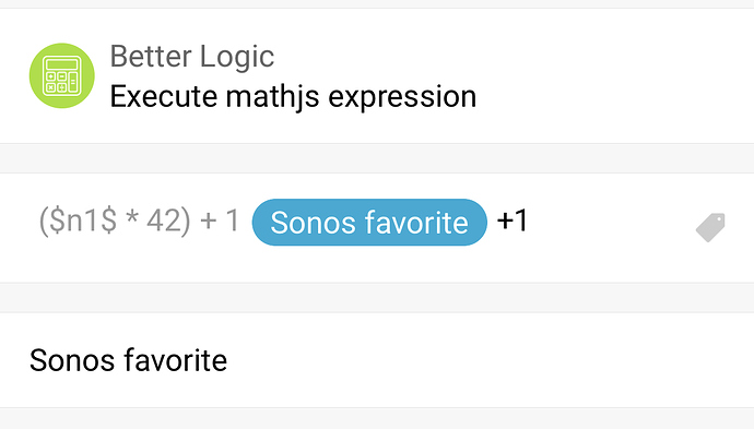

**Author:** ![Osorkon](https://sea1.discourse-cdn.com/flex025/user_avatar/community.homey.app/osorkon/32/43026_2.png) [@Osorkon](https://community.homey.app/u/Osorkon)\
**Post date:** [August 6, 2019, 10:17am UTC](https://community.homey.app/t/toggle-next-sonos-playlist-from-a-button/16498/5 "2019-08-06T10:17:51Z")
</div>
I use the better logic app.
 ![image](https://us1.discourse-cdn.com/flex025/uploads/athom/original/2X/5/5643a5543f56ae7bb85b595d89836d6eee1807ce.jpeg)

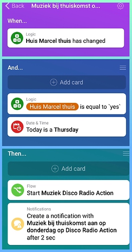

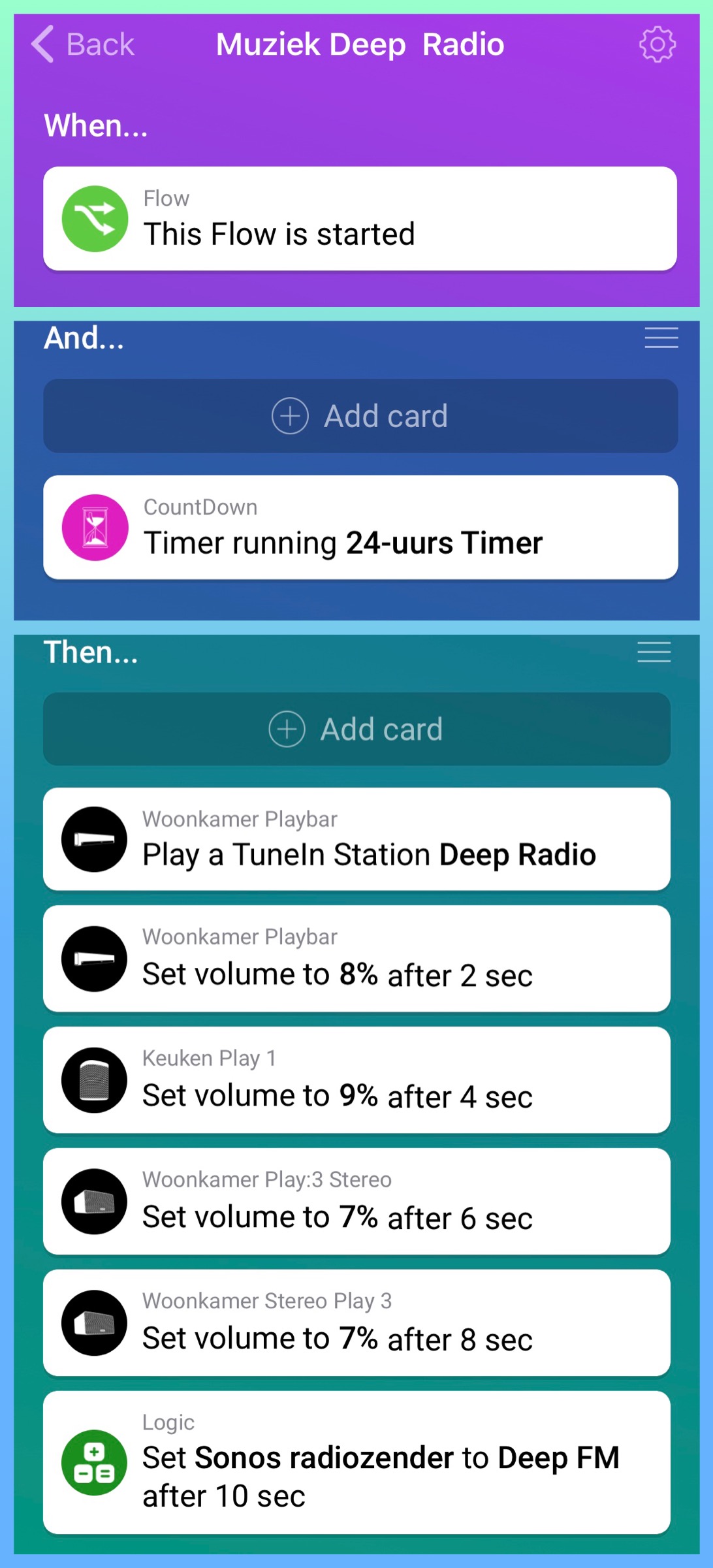

**Author:** ![Marcel\_Ubels](https://sea1.discourse-cdn.com/flex025/user_avatar/community.homey.app/marcel_ubels/32/18860_2.png) [@Marcel\_Ubels](https://community.homey.app/u/Marcel_Ubels)\
**Post date:** [August 11, 2019, 10:01am UTC](https://community.homey.app/t/toggle-next-sonos-playlist-from-a-button/16498/6 "2019-08-11T10:01:43Z")
</div>
This is the way I do it, also have a remotec 8 button switch. Pushing button 4 starts a radiostation depending on the day of the week
 ![image](https://us1.discourse-cdn.com/flex025/uploads/athom/original/2X/8/8b350929bf26bb0d8527e4b6f1b34c2ff96283c1.jpeg) ![image](https://us1.discourse-cdn.com/flex025/uploads/athom/original/2X/1/14673551e92a35844a0a004ca92e6f17ef254837.jpeg) .
