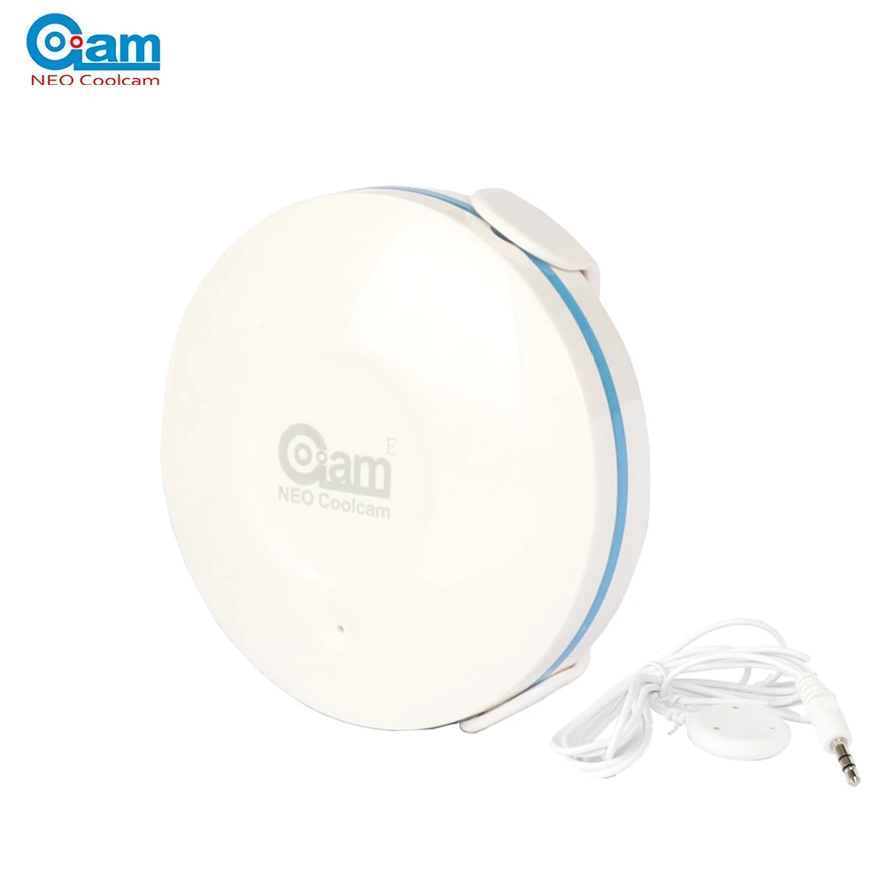

We have a water pump that evacuates water from a drainage-well outside in the garden. For several reasons, I would like to control the pump activity via Homey.
I am looking for a sensor that will be in contact with water several times a day, all year round ( I wonder if the sensors for water leakage are designed for this exposure or only for occasional emergency leakage??)
Anyone, that have this or similar set-up? suggestions for a sensor?

> **[US $28.0 20% OFF|NEO COOLCAM NAS WS02Z Z wave Flood Water Leak Alarm Sensor...](https://www.aliexpress.com/item/32787289062.html?spm=2114.search0204.3.103.222a5388a3AxuU&ws_ab_test=searchweb0_0%252Csearchweb201602_3_10065_10068_10843_319_10059_10884_317_10887_10696_321_322_453_10084_454_10083_10103_10618_10304_10307_10820_10301_10821_537_536%252Csearchweb201603_60%252CppcSwitch_0&algo_expid=a6813010-cfef-4ee0-8719-68caa68f07d6-13&algo_pvid=a6813010-cfef-4ee0-8719-68caa68f07d6&transAbTest=ae803_5)**
> Smarter Shopping, Better Living! Aliexpress.com

Both Fibaro flood sensors and Aeotec flood sensors work.
Both have the option to wire external probes so they stay away from being immersed into the water.
I use this successfully and the probe is nothing but a pair of ordinary wires which I stripped the ends and when they touch water, the alarm is ON.
Hope this helps.
