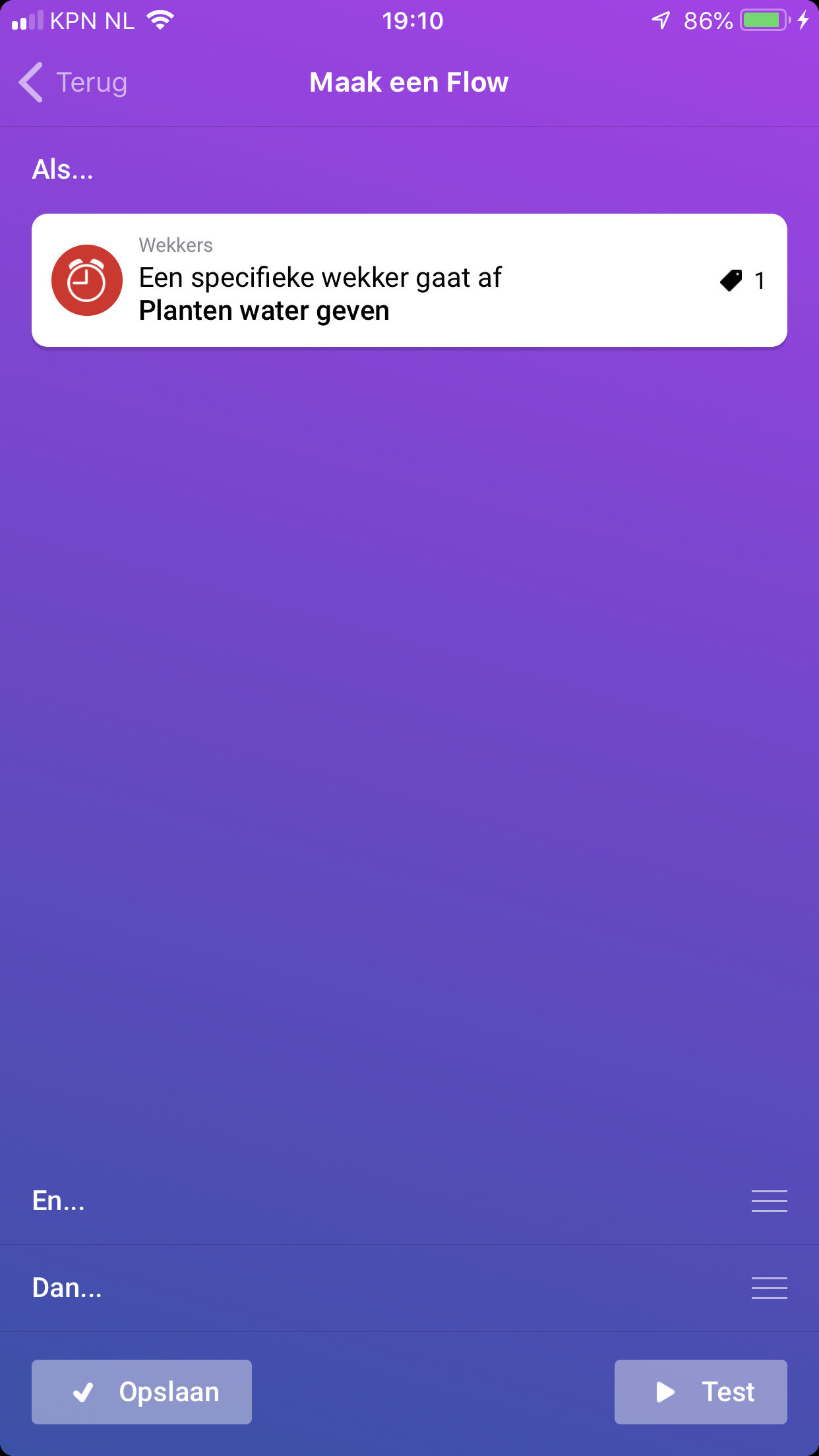

I just made a flow to remind me to watering the plants. I want to make the led ring blue pulsating voor 540 minutes. When I test the flow its working. But when I save or delete the flow, the test is still running. I can’t also reset the led ring in the settings. Can you make a stop test button or something?

strange…i wonder how that flow that you nade looks? looks more like some loop you have created
Normally you should be able to change the ledring at settings

![image](https://us1.discourse-cdn.com/flex025/uploads/athom/original/2X/3/3929b364dbfcbec5bd1329ef3c98e3d2832f6a51.jpeg) ![image](https://us1.discourse-cdn.com/flex025/uploads/athom/original/2X/8/8d3107a192947d0eba5ed98ad66c9fed69ca6d88.jpeg) ![image](https://us1.discourse-cdn.com/flex025/uploads/athom/original/2X/c/c603851c18278267874d9781efc733dac420e96d.jpeg)
