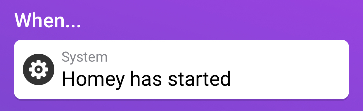

Is it possible to automatically start a flow after a reset and/or system update?
Background: my homey received a system update tonight. For unknown reasons, this triggers all the lights to switch on. I would like to have them restored to the state they where in before the update, but that won’t be easy. A simple flow that would trigger at system startup would allow an easy fix.

![image](https://us1.discourse-cdn.com/flex025/uploads/athom/original/3X/9/2/92470d99bd99a508caad0987f076ae4363e1eebf.jpeg)
Make sure to enable power user in settings/experiments

Thx, hopefully that’ll work.
