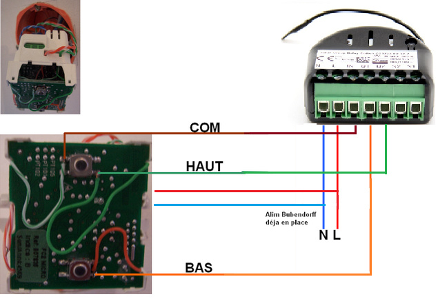

Hi, i need your help to configure my fibaro fgs-222. I soldered my micromodule to the control CPL bubendorff to control all my shutters(in attachement) and now I need to create a flow to start the opening / closing shutters.
the difficulty here is t ![fib](https://us1.discourse-cdn.com/flex025/uploads/athom/original/3X/c/e/ce9be8e418433c5b07c013445015a1d1c7caabbc.jpeg) hat I have to run a “up + down” command to activate the bulk command … only then can I send a simple command to control the meaning of the shutter.
Is-it possible for you?if yes can you help me to build the flow?
Thx
Edit: problème solved:
 ![Screenshot_20191205-123331](https://us1.discourse-cdn.com/flex025/uploads/athom/original/3X/7/9/790c672fc8da41af53e6f1c7075c5ab10cc63172.jpeg)
