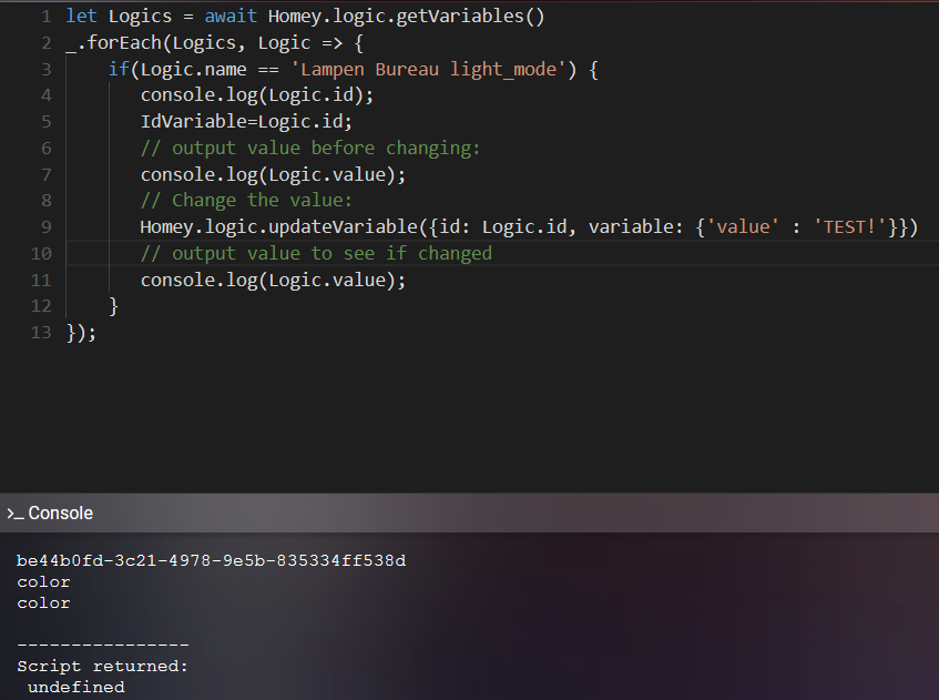

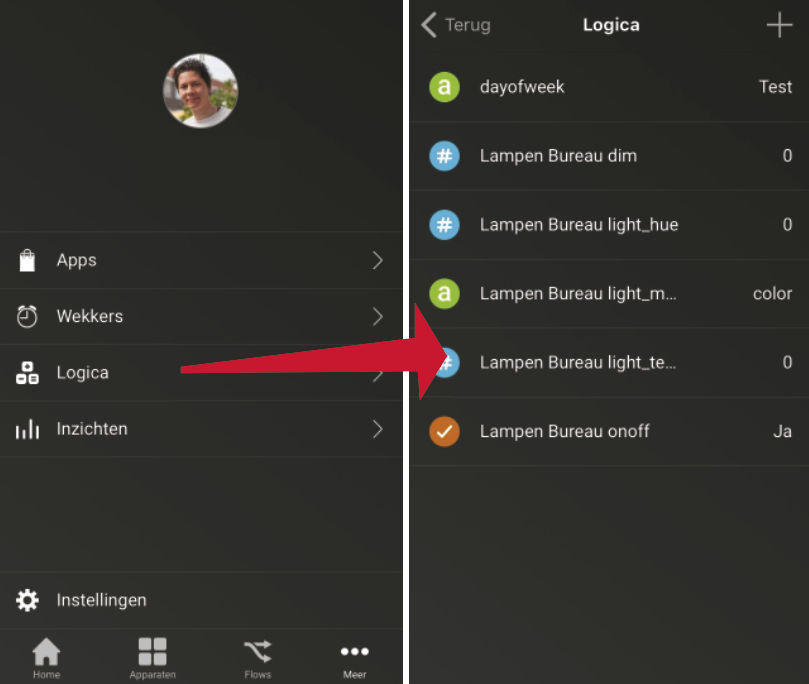

Can someone supply me with an example code how I can change a global variable or “tag” inside HomeyScript? I’m trying to change these tags:
 ![homey-tags](https://cdck-file-uploads-us1.s3.dualstack.us-west-2.amazonaws.com/flex025/uploads/athom/original/2X/8/8dd5de16b5c868803fe1f3df5fc034bb1ac9adf3.png)
I’ve managed to read the variables:
 ![HomeyScript-GlobalVariable](https://cdck-file-uploads-us1.s3.dualstack.us-west-2.amazonaws.com/flex025/uploads/athom/original/2X/f/f1645f0a32f08d85af80e0c22b01cb4ae4884934.png)
But I have no clue how to change them inside HomeyScript, as you can see from the console window, the value does not get updated. I’ve seen several posts about it, but all the scripts doesn’t seem to work or the thread is abandoned.
`Homey.logic.updateVariable({id: Logic.id, variable: {'value' : 'TEST!'}})`
Doesn’t seem to work… but maybe I have mistaken the syntax. Anyone can provide me a working syntax?

Homey script isn’t allowed to change variable values, only retrieve them.

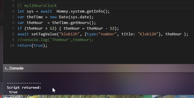

@Satoer The good news is, you can make your own variables in HomeyScript and they also can be used in your Flows, here is my example:
// my12HoursClock
let sys = await Homey.system.getInfo();
var theTime = new Date(sys.date);
var theHour = theTime.getHours();
if (theHour > 12) { theHour = theHour - 12};
await setTagValue("klok12h", {type:"number", title: "Klok12H"}, theHour );
//console.log('TheHour',theHour);
return(true);

The code:
`await setTagValue(“klok12h”, {type:“number”, title: “Klok12H”}, theHour );`
in your script, gives the error:
> Invalid or unexpected token: Invalid or unexpected token

just tried to run it, no problem:

found the error… The pasted quotes : **"** where not the same. The compiler didn’t see the code between the quotes as strings. 🙈
Anyway, the code did run. Sadly I cannot find any trace of stored tags if I enumerate all the devices. I think these tags are only created at runtime. Makes more sense also, otherwise it would be a memory leak if these things never get destroyed.
So if anyone know a solution to store a variable, and retrieve that variable at a later stage with a different Homeyscript… I’m all ears. Thanks anyway JPE4619 for the support.
