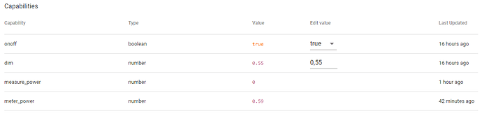

I want to make my own dashboard. I can build website from scratch, but i have seriously no idea where to start 🙂
Does anybody know if there is a example of a (php) code, to trigger capability’s off added devices.
Or even a basic code that logs in into my Homey en can show the capability-parameters of devices.
I mean device capability’s like this:
 ![capa](https://us1.discourse-cdn.com/flex025/uploads/athom/original/2X/a/a77b386352afa730506356ddb08f0a571cf8fd65.png)
Thank you so much for your time!

php? you should switch to javascript. --\> [developers.athom.com](http://developers.athom.com)

You might want to checkout the REST api.
> [@\[Unsupported\] Homey v2 REST API](https://community.homey.app/t/unsupported-homey-v2-rest-api/7268):
> I am not sure whether this topic is allowed. But I thought I share my findings for the v2 API. I have personal use cases for directly calling the API through iOS shortcuts. In v2, the on and off REST API path has changed to /capability/onoff from /state. So now to switch on: PUT { "value": true } TO http://\<HOMEY\_IP\>/api/manager/devices/device/\<DEVICE\_ID\>/capability/onoff and to switch off: PUT { "value": false } TO http://\<HOMEY\_IP\>/api/manager/devices/device/\<DEVICE\_ID\>/capability/onoff O…
