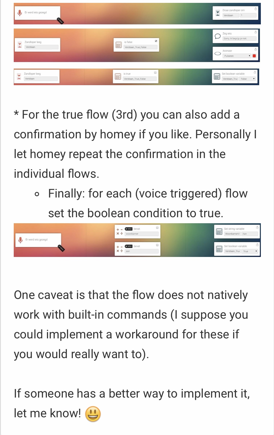

There was an[example on the old forum](https://forum.athom.com/discussion/comment/31873/#Comment_31873) about this.

@Rocodamelshekima when i click you link i get a sad smiley site with the following tekst:
# Permission Problem
You don’t have permission to do that.
I can post a picture of it if you need more info

![image](https://us1.discourse-cdn.com/flex025/uploads/athom/original/2X/a/aeaaae27949eda1562790a6207ddeb31a8ed2cbb.jpeg) ![image](https://us1.discourse-cdn.com/flex025/uploads/athom/original/2X/e/e158d5bd37239904070646ab63046946f772eed9.jpeg)

Thanks,
Are there bigger images of the flows available, because they are very much unreadable. I’d like to try this this weekend.

> [@Bart\_Teunissen](#):
Did u try to click on the images?

Yes i did, and the forum tekst in the image is really clear, but the flow images (in the image itself) are very small and unreadable. 🙂

![image](https://us1.discourse-cdn.com/flex025/uploads/athom/original/2X/6/66f40677439a9bf23d447dc6db5491da67259987.jpeg)
Uhm, ok.

@Rocodamelshekima: Let me help you… 😉
[Flow library : your input for advanced flows](https://forum.athom.com/discussion/1943/flow-library-your-input-for-advanced-flows)
