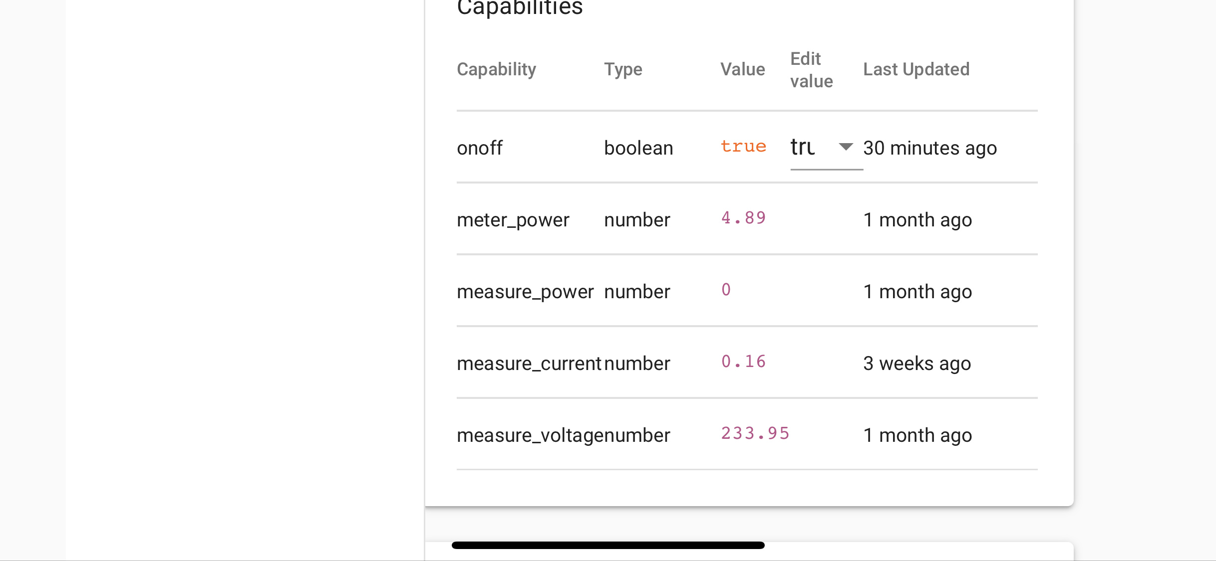

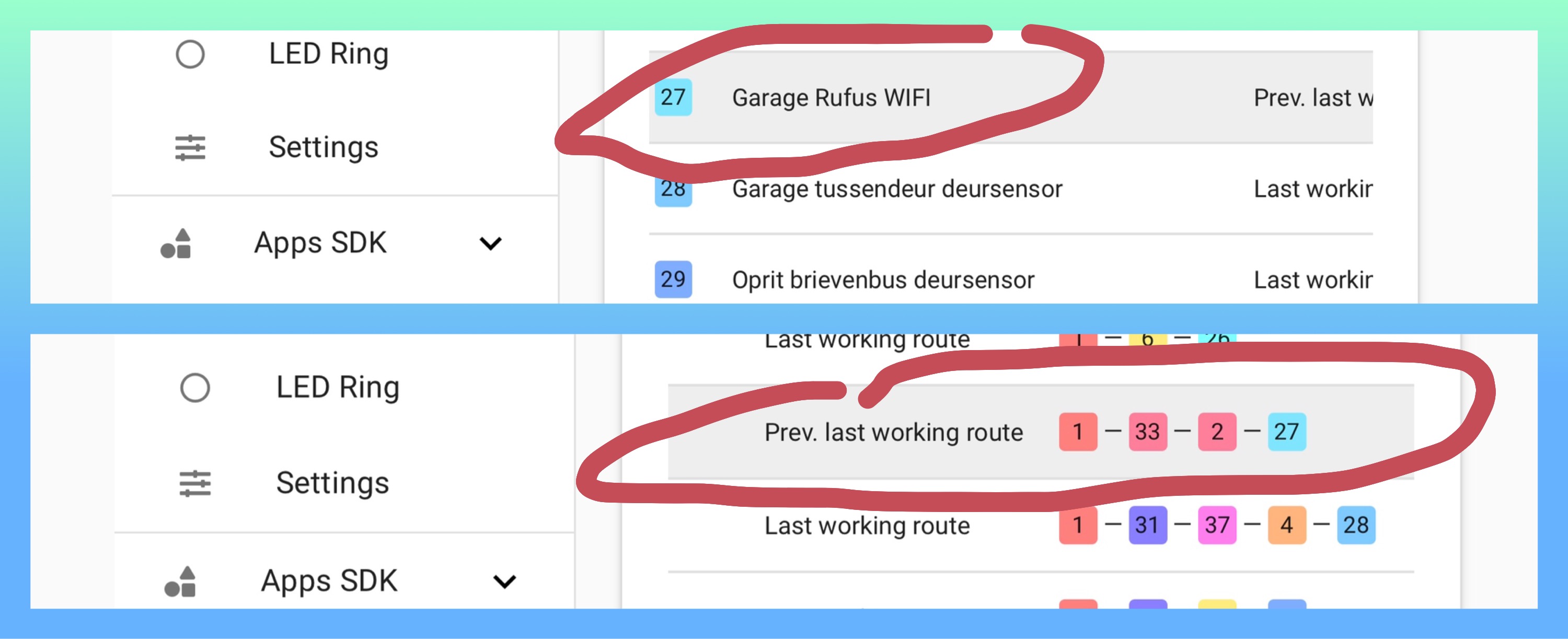

I have a neo wallplug but can not find it in my house. Anyone an idea how to find it. Did control every wall socket. Nodes 2 and 33 are also not available when I look at de developers tool.

Check power consumption and narrow it down whether it’s a lamp or something power consuming?

![image](https://us1.discourse-cdn.com/flex025/uploads/athom/original/2X/6/66044511bee5e6ab2ca8045fd9ec963e9d656d0d.jpeg)

0.16A ~ 35W? Maybe a light bulb?

Did you try a heal, a basic on and a basic off?
“previous last working route” seems to point to a device which didn’t report for some time? After a heal to nearby routers should show… Is the basic on/off acknowledged?

As it hasn’t reported in 3 weeks, I think it has been taken out of its socket, so has no power to switch anything.
Or is far away from homey, looking at its name it is in the garage which can be too far/to well isolated.
As @bvdbos is already suggesting, you could try a healing route

![afbeelding](https://us1.discourse-cdn.com/flex025/uploads/athom/original/2X/a/af9e6838db4c9956584d7995da50da17a899a3e9.png)

I get these messages

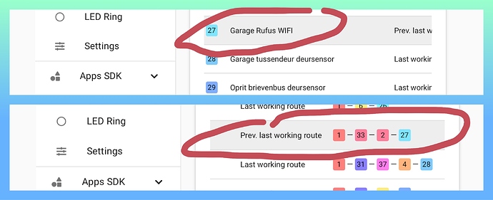

 ![image](https://us1.discourse-cdn.com/flex025/uploads/athom/original/2X/2/28607b1e3efc524643d11d2936b4d2f9faa2b23a.jpeg)

Then the plug is probably unplugged or out of range. The first two don’t wait for an acknowlegde-received-message. The second two do… You could try to look at insights or the on/off log to see when it stopped reporting. Mayeb then you get the idea what you did then?

I have removed it with help of the developers page. On the device page it was not possible to remove because I had to push a button three times. Afterwards looking at my flows, there was no single flow with this device. I think that I renamed this device earlier and for some odd reason it also stayed in my device with the old and new name. Problem solved.
