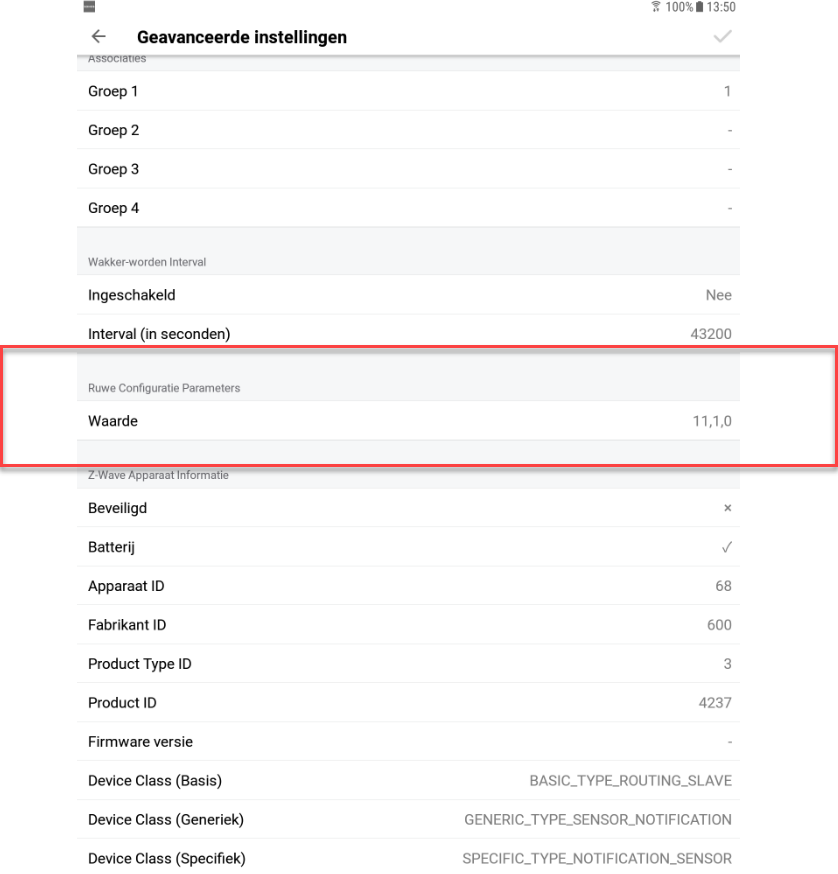

never mind, I’ve already found it.

11,1,0 what does that exactly mean? If I look in the manual parameter 10 should be a byte set to 0 or 1, so I would expect 10,1,0 (10 for the parameter, 1 for a byte, 0 for the actual value).
Maybe I am mistaken and it means something completely different. Paramater 11 (which I think is 11,1,0) is MotionEventReportOneTimeEnable.

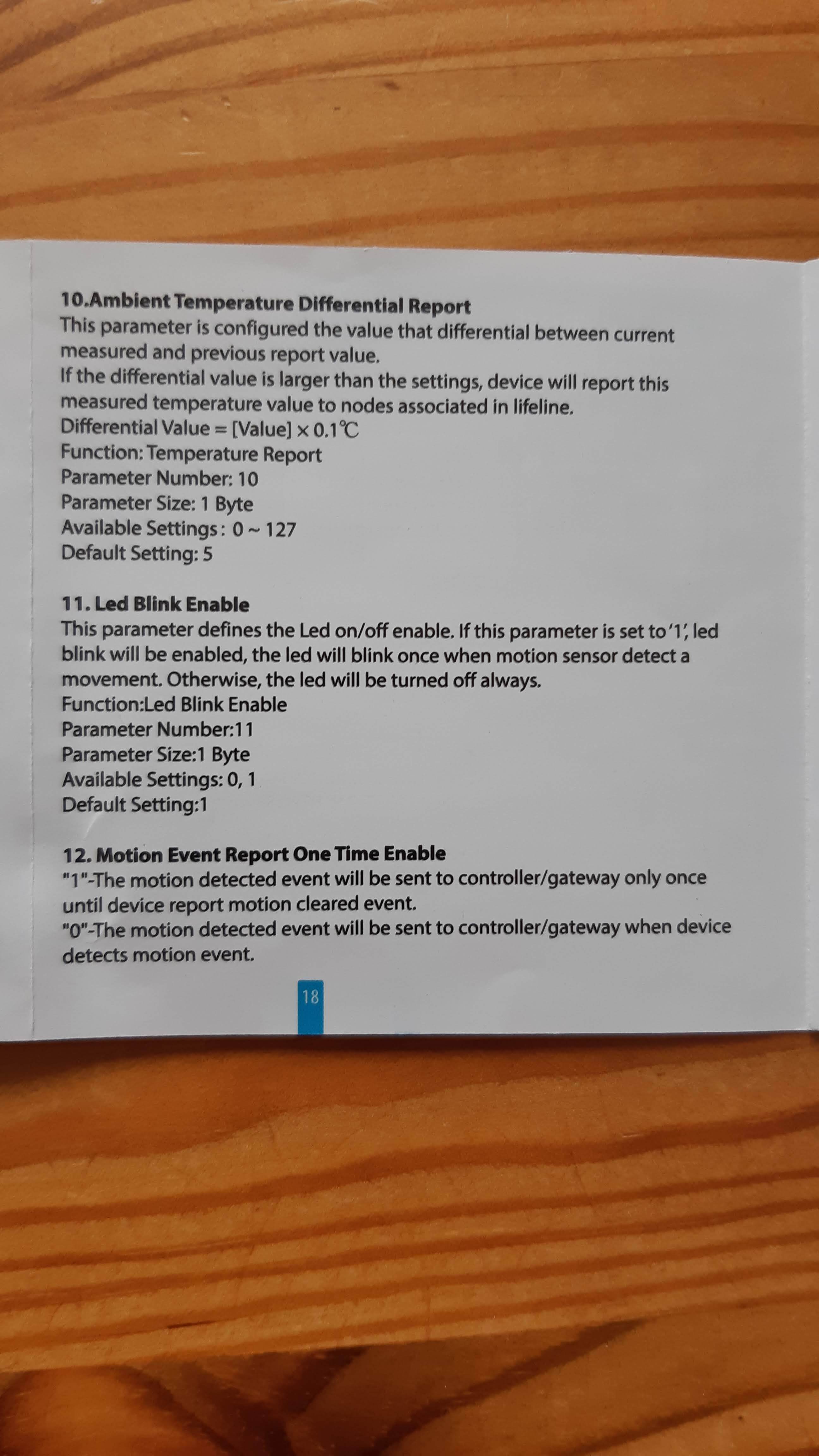

My manual says something else

Strange, mine says parameter 10, looked it up in several of my sensors’ manuals and all are the same, but most importantly: I now know how it works.
