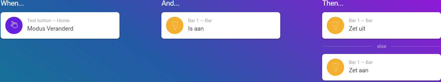

Works here
 ![chrome_2019-09-28_16-50-07](https://us1.discourse-cdn.com/flex025/uploads/athom/original/2X/9/98b6e19ab730cfaa17ce36dba25dbb26fbc758ce.png)

I tried a new one and before I linked it to a flow I turned if off, that seemed to have worked 🙂 so gonna change all of them 🙂
