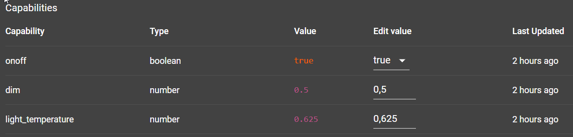

@HarriedeGroot:
I am a bit of a MQTT-newbie, so I hope I answer your questions correctly… 🙂
> [@HarriedeGroot](#):
> Which topics are available?
> What information is posted to the /set topic from HA?
This is what is shown in MQTT explorer:
 ![MQTT_Explorer](https://us1.discourse-cdn.com/flex025/uploads/athom/original/3X/c/d/cd34a909784479dc63e162b80a0ccc96bc8325e4.png)
Value color set = 420 is set by HA. But does not pass through to Homey.
When I change color temperature in Homey, nothing in MQTT Explorer seems to change.

@Henk_Renting Your screenshot of the topic tree in mqtt explorer only shows the properties ‘onoff’ and ‘dim’.
What capabilities are available for this device?
This info can be found here: [Homey Developer](https://developer.athom.com/tools/devices)
Is there a ‘color’ capability?

@Henk_Renting I don’t know for sure if this is the correct formula for the color temp calculation:
Homey color temp = (({value\_from\_ha} / 100) \* (500 - 153)) + 153
Does it (still) work for Philips Hue bulbs?
Probably the min & max mired values of the IKEA bulbs differ from the values of the Hue bulbs?
The correct calculations can probably be found here:
> <https://github.com/rogro82/io.homeassistant/blob/master/drivers/light/device.js>
<div class="post-metadata">
**Author:** ![Henk\_Renting](https://sea1.discourse-cdn.com/flex025/user_avatar/community.homey.app/henk_renting/32/87634_2.png) [@Henk\_Renting](https://community.homey.app/u/Henk_Renting)\
**Post date:** [April 29, 2021, 6:31pm UTC](https://community.homey.app/t/mqtt-hub-gateway/6766/927 "2021-04-29T18:31:23Z")
</div>
@HarriedeGroot
Thanks for the extensive answer. Hopefully the following information is helping?
These are the capabilities in the developer site. I guess the one you are referring to is “light\_temperature”
 ![Developer Homey](https://us1.discourse-cdn.com/flex025/uploads/athom/original/3X/9/3/9360fea3ba18a21db7f5721d6fee496b9fd6f7ab.png)
Unfortunately I have no Hue (or other) bulbs to test; sorry.
Perhaps there is another Community member who can help us out there?
It seems max color temperature in Homey ranges from 0 (most white/cold) to 1 (most yellow/warm).
In Home Assistant these ranges are from 153 (most white/cold) to 500 (most yellow/warm).
So I suppose you are right that the calculations are incorrect or at least the values don’t seem to correspond.

‘light\_temperature’ is indeed the capability we’re looking for. The strange part: this capability isn’t provided as a mqtt homie propery for your light (mqtt explorer screenshot).
