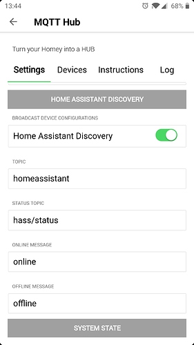

**Author:** ![HarriedeGroot](https://sea1.discourse-cdn.com/flex025/user_avatar/community.homey.app/harriedegroot/32/56160_2.png) [@HarriedeGroot](https://community.homey.app/u/HarriedeGroot)\
**Post date:** [August 6, 2019, 11:43am UTC](https://community.homey.app/t/mqtt-hub-gateway/6766/640 "2019-08-06T11:43:56Z")
</div>
@jolerius see: [https://www.home-assistant.io/docs/mqtt/birth\_will/](https://www.home-assistant.io/docs/mqtt/birth_will/)
 ![Screenshot_20190806-134445](https://us1.discourse-cdn.com/flex025/uploads/athom/original/2X/e/ec5a5d9d196faf30621437ad6e6cc1e5f95c3c9a.jpeg)

great, will it broadcast all devices even after homey reboot?
i have more problems. One of my lights, connected to a qubino dimmer, doesnt show up as light in HASS. So i cant control it from there. Any clue?
